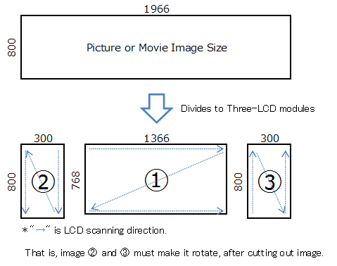

Dear all,
We have planned the Signage product for the amusements using i.MX6.
It has 3LCD panel.
It handles the unusual size image.
I want to know whether this can be implemented only by i.MX6.
For example, (1)HDMI, (2)LVDS, and (3)LVDS are available as a LCD interface.
Because it is Signage equipment, needed functions are pictures display and movie playback.
In others:
  • display these two in layers.
  • scan frequency is 15-30fps.
Is implementation possible?
When using BSP as the base, is many change needed for S/W?

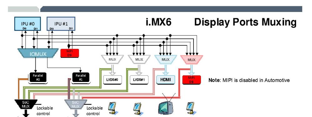

igorpadykov
Hi George
I think this is feasible only with i.MX6QD, since it
has 2xIPU. In my opinion sw changes may be significant,
also attached i.MX6QD porting guide.
igor

george
Senior Contributor II
Dear Igor,
I was glad that your opinion could be heard.
I think S/W change a few more after this.
Please let me know one.
Can multiple monitors be handled as one monitor virtually in such environment?
BR,
George
6,201 Views
igorpadykov
Hi George
yes I think i.MX6QD can do that.
igor
