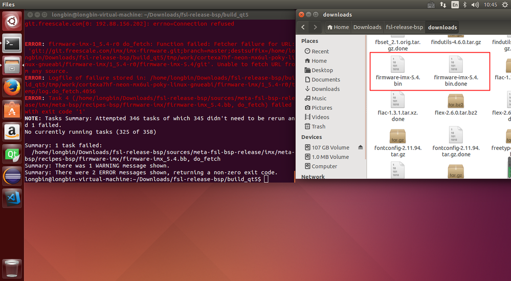

我按上面的方法出现两个问题。
问题1:我已经把firmware-imx-5.4.bin和firmware-imx-5.4.bin.done拷贝到downloads,然后不管我bitbake firmware-imx还是bitbake fsl-image-qt5都出现:
WARNING: firmware-imx-1_5.4-r0 do_fetch: Failed to fetch URL git://git.freescale.com/imx/imx-firmware.git;branch=master;destsuffix=/home/longbin/Downloads/fsl-release-bsp/build_qt5/tmp/work/cortexa7hf-neon-mx6ul-poky-linux-gnueabi/firmware-imx/1_5.4-r0/firmware-imx-5.4/git, attempting MIRRORS if available
ERROR: firmware-imx-1_5.4-r0 do_fetch: Fetcher failure: Fetch command failed with exit code 128, output:
Cloning into bare repository '/home/longbin/Downloads/fsl-release-bsp/downloads//git2/git.freescale.com.imx.imx-firmware.git'...
fatal: unable to connect to git.freescale.com:
git.freescale.com[0: 192.88.156.202]: errno=Connection refused
ERROR: firmware-imx-1_5.4-r0 do_fetch: Function failed: Fetcher failure for URL: 'git://git.freescale.com/imx/imx-firmware.git;branch=master;destsuffix=/home/longbin/Downloads/fsl-release-bsp/build_qt5/tmp/work/cortexa7hf-neon-mx6ul-poky-linux-gnueabi/firmware-imx/1_5.4-r0/firmware-imx-5.4/git'. Unable to fetch URL from any source.
ERROR: Logfile of failure stored in: /home/longbin/Downloads/fsl-release-bsp/build_qt5/tmp/work/cortexa7hf-neon-mx6ul-poky-linux-gnueabi/firmware-imx/1_5.4-r0/temp/log.do_fetch.4135
ERROR: Task 4 (/home/longbin/Downloads/fsl-release-bsp/sources/meta-fsl-bsp-release/imx/meta-bsp/recipes-bsp/firmware-imx/firmware-imx_5.4.bb, do_fetch) failed with exit code '1'

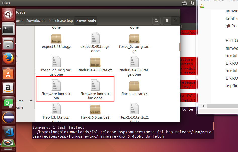

从图可以看到我downloads是有firmware-imx5.4.bin和firmware-imx-5.4.bin.done

I have already attached it, pls read my document again, I uploaded the firmwar-imx git2 package, try to unzip first, then put packages under downloads/git2, then "bitbake firmware-imx" again

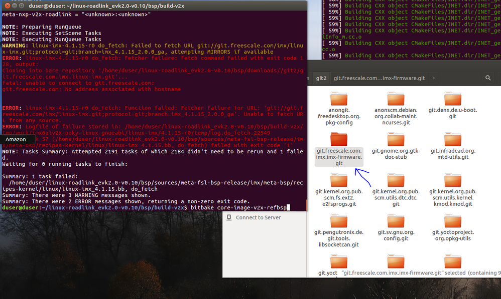

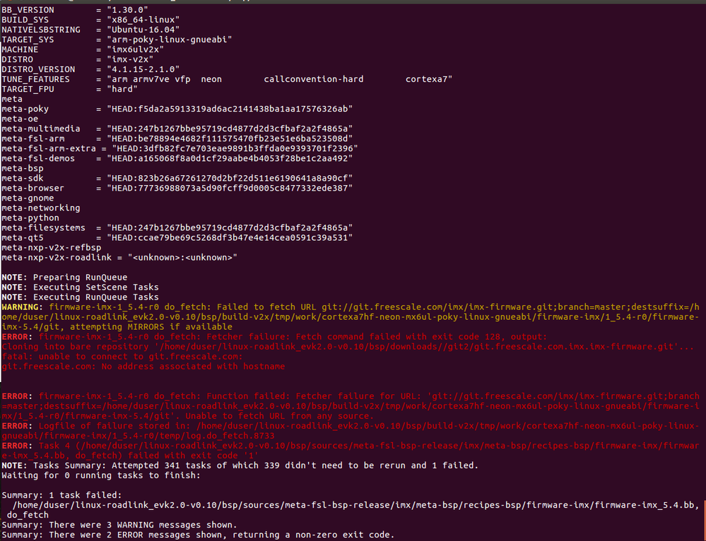

Hi Need quick help
I havecopied ffirmware bin in download folder and firmware.gut in git2 folder when i an trying to compiler still bitbake is trying to download
| ERROR: Function failed: do_configure (log file is located at /home/msabnam/w117/build/tmp/work/x86_64-linux/qemu-native/2.5.0-r1/temp/log.do_configure.23854)
ERROR: Task 1187 (virtual:native:/home/msabnam/w117/Eagle-Distribution/oe-core/meta/recipes-devtools/qemu/qemu_2.5.0.bb, do_configure) failed with exit code '1'
WARNING: firmware-imx-1_5.4-r0 do_fetch: Failed to fetch URL git://github.com/NXP/imx-firmware.git;protocol=https;branch=master;destsuffix=imx-firmware;name=imx-firmware, attempting MIRRORS if available
ERROR: firmware-imx-1_5.4-r0 do_fetch: Fetcher failure: Unable to find revision 951c1363abe95dd75ab3e9447f640d7807240236 in branch master even from upstream
ERROR: firmware-imx-1_5.4-r0 do_fetch: Function failed: Fetcher failure for URL: 'git://github.com/NXP/imx-firmware.git;protocol=https;branch=master;destsuffix=imx-firmware;name=imx-firmware'. Unable to fetch URL from any source.
ERROR: Logfile of failure stored in: /home/msabnam/w117/build/tmp/work/cortexa9hf-neon-mx6qdl-oe-linux-gnueabi/firmware-imx/1_5.4-r0/temp/log.do_fetch.23884
ERROR: Task 226 (/home/msabnam/w117/Eagle-Distribution/oe-core/../meta-fsl-arm/recipes-bsp/firmware-imx/firmware-imx_5.4.bb, do_fetch) failed with exit code '1'
NOTE: Tasks Summary: Attempted 952 tasks of which 926 didn't need to be rerun and 3 failed.
