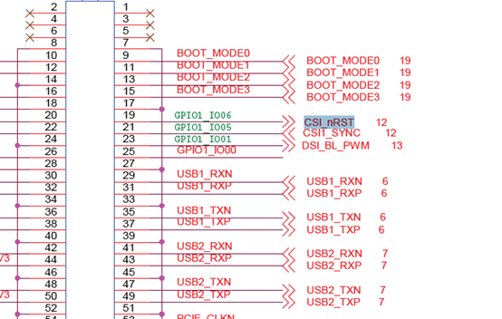

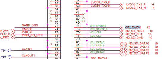

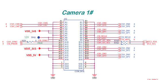

Refer to the imx8mp evk baseboard schematic, we can find camera 1# and camera 2# share the same reset and power down pins
Refer to the schematic, current evk uses gpio2_IO11 as power down pin and gpio1_IO06 as reset pin, but let’s see the i.mx8mp-evk.dts file
<https://source.codeaurora.org/external/imx/linux-imx/tree/arch/arm64/boot/dts/freescale/imx8mp-evk.d...>

So if customer wants connect I2C3 to ov5640, don’t forget change the power down pin and reset pin as what schematic defines
Then you can find the issue obviously in this dts file, and pls try to correct as below:
https://source.codeaurora.org/external/imx/linux-imx/tree/arch/arm64/boot/dts/freescale/imx8mp-evk-o...
&i2c3 {
      /delete-node/ov2775_mipi@36;
&ov5640_1 {
-       pinctrl-0 = <&pinctrl_csi1_pwn>, <&pinctrl_csi1_rst>, <&pinctrl_csi_mclk>;
+      powerdown-gpios = <&gpio2 11 GPIO_ACTIVE_HIGH>;
 +      reset-gpios = <&gpio1 6 GPIO_ACTIVE_LOW>;
         csi_id = <1>;
      status = "okay";
That’s why some customers tested ov5640 by imx8mp-evk-ov2775-ov5640.dts file failed
  • Dual ov5640
Because ov5640 has ISP, so current bsp connect ov5640 by ISI, so customer can set status of &isi_0 or &isi_1 to “Okay” in the dts file if you just connect one ov5640, Because of evk HW limitation, current board couldn’t support dual ISI, which mean couldn't support dual ov5640, because they share the same power down pin and reset pin, so customer only can connect ov5640 by ISI0 or ISI1 to test
