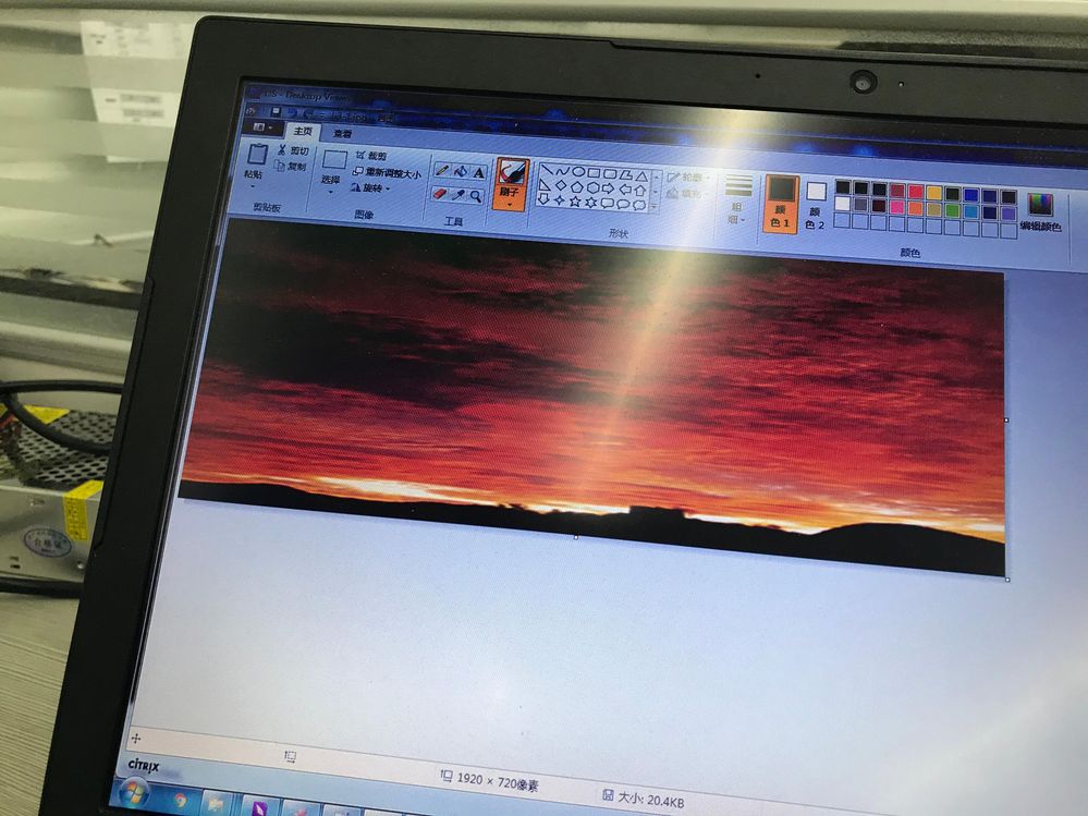

The attached "rear_view_camera_jpegdec.tar.bz2" is the updated source code for "SDK\boards\mekmimx8qx\demo_apps\rear_view_camera". It is based on SDK 2.5.1 for iMX8QXP MEK.
The "rear_view_camera_jpegdec.patch" is the modified code, it hasn't included the added "fsl_jpeg_dec.c" and "fsl_jpeg_dec.h".
The testing used two 256*256 JPEG files, they are RGB color space. We used followed commands to build them into flash.bin:

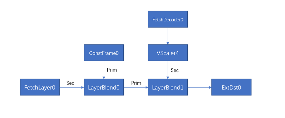

Based on JEPG decoder, added DPU CSC support and render JEPG decoded video in overlay window.
The architecture is followed: NXP logo is put in FetchLayer0 with RGB565 format, after LayerBlend0, it will be the prim layer for LayberBlend1 (FetchLayer0 can't be used as prim layer for LayerBlend), the JPEG decoder output is put to FetchDecoder0. RGB888 format, and it will be resize to 640*480, and put to x=100, y=100 of the display. (Only the sec layer of LayerBlend can be window mode).

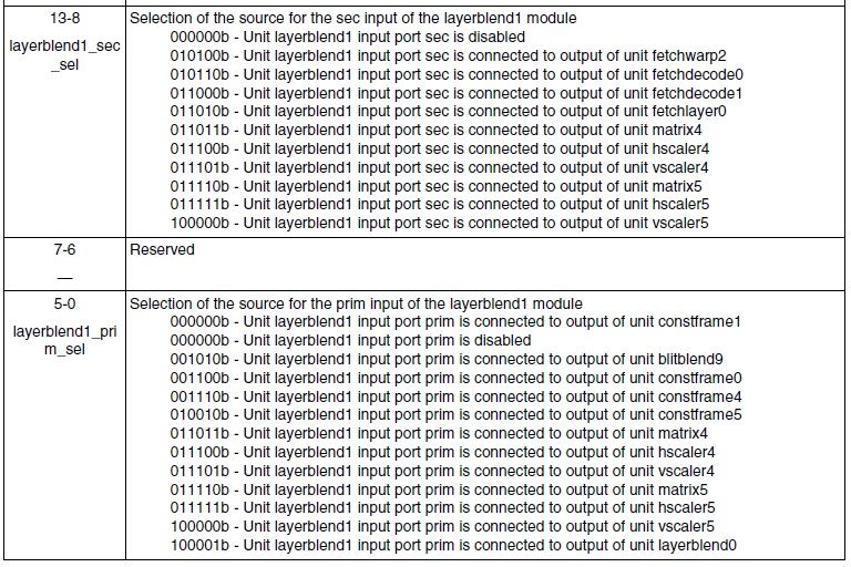

Some limitation for layer selection in LayerBlend:

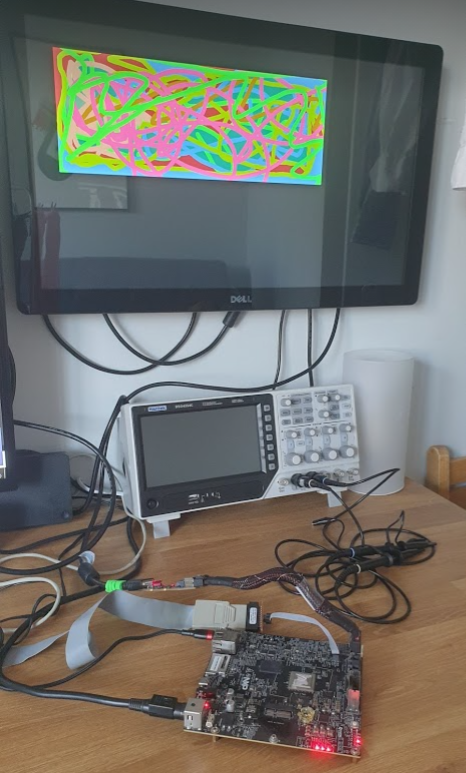

Thank you @qiang_li-mpu_se for sharing, works like a charm.

If you use a Lauterbach probe you can also avoid using mkimage, but just load jpeg images thru JTAG by adding the following command in your cmm file:
data.load.binary "256x256_1.jpg" 0x84000000
data.load.binary "256x256_2.jpg" 0x84008000
I have monitored the decode time for a 1280x480 file and it is quite fast, including OS overhead and display, it last #5.1ms:
