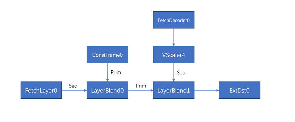

Based on JEPG decoder, added DPU CSC support and render JEPG decoded video in overlay window.
The architecture is followed: NXP logo is put in FetchLayer0 with RGB565 format, after LayerBlend0, it will be the prim layer for LayberBlend1 (FetchLayer0 can't be used as prim layer for LayerBlend), the JPEG decoder output is put to FetchDecoder0. RGB888 format, and it will be resize to 640*480, and put to x=100, y=100 of the display. (Only the sec layer of LayerBlend can be window mode).
Some limitation for layer selection in LayerBlend:
