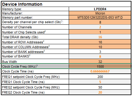

  1. First, the user needs to update the RPA Register Configuration worksheet tab
Device Information table “Clock Cycle Freq (MHz)“ setting to the desired DRAM frequency

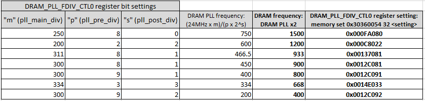

Below is a table of various frequencies to choose from.  For frequencies not listed in the table below, it is up to the user to calculate a new register setting based on the formula:
(24MHz x m)/(p x 2^s)
Where “m” represents the PLL_MAIN_DIV, “p” represents the PLL_PRE_DIV, and “s” represents the PLL_POST_DIV.
NOTE:  The DRAM frequency is double the DRAM PLL frequency
DRAM_freq = DRAM_PLL x 2

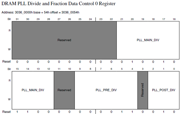

The DRAM PLL register and bit settings are shown below:
The following table provides examples of the various settings to create the desired frequency:
For example, in the i.MX 8M Mini LPDDR4 RPA where the default DRAM frequency is 1500MHz, let’s assume that the user instead wants 1200MHz.
First, the user changes the RPA Register Configuration worksheet tab Device Information table “Clock Cycle Freq (MHz)“ setting to 1200.
Next, in the RPA DDR stress test file worksheet tab search for “memory set 0x30360054” and replace “0xFA080” (original setting from DRAM frequency 1500MHz) with “0x000C8022 (updated for DRAM frequency 1200MHz).  Note that for a DRAM frequency of 1200MHz, the DRAM PLL is configured for 600MHz, as the DRAM frequency is double the DRAM_PLL.
