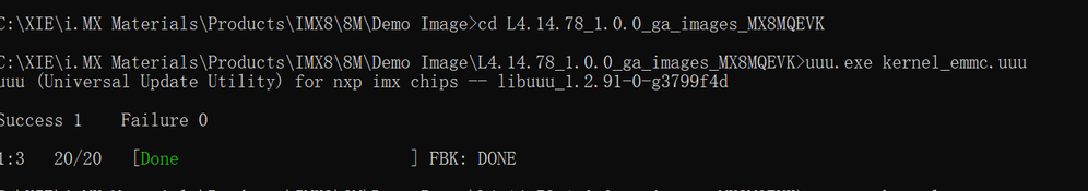

For the 4.14.78, we don’t use mfgtool anymore, customer can use uuu.exe to program the image to the board, the uuu.exe can be found from https://github.com/NXPmicro/mfgtools/releases
Here we use emmc as media, I attached the kerel_emmc.uuu for reference
Open the cmd.exe, then use the command “uuu.exe kernel_emmc.uuu” to download the image to the emmc on the board as the picture shows

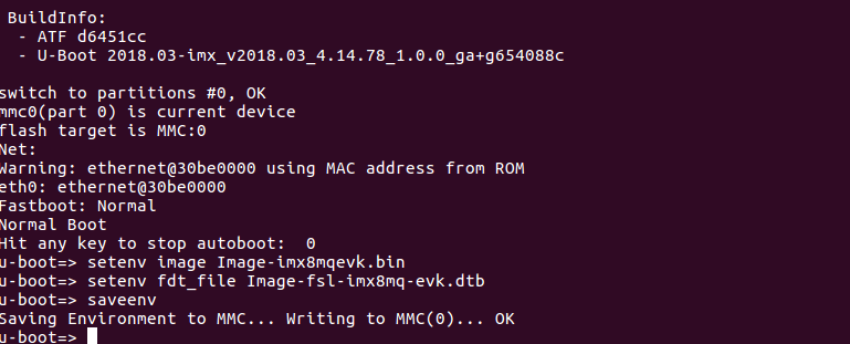

When the board boot up, don’t forget to change the image and fdt_file as you want, for example, I use Image-imx8mqevk.bin as image name  and Image-fsl-imx8mq-evk.dtb as my fdt file, you can choose different image and fdt file as uuu file mentions.

For play the two different video to the different display, current imx8M evk board supports dual hdmi output, in the uboot command:
setenv fdt_file Image-fsl-imx8mq-evk-dual-display.dtb
saveenv
