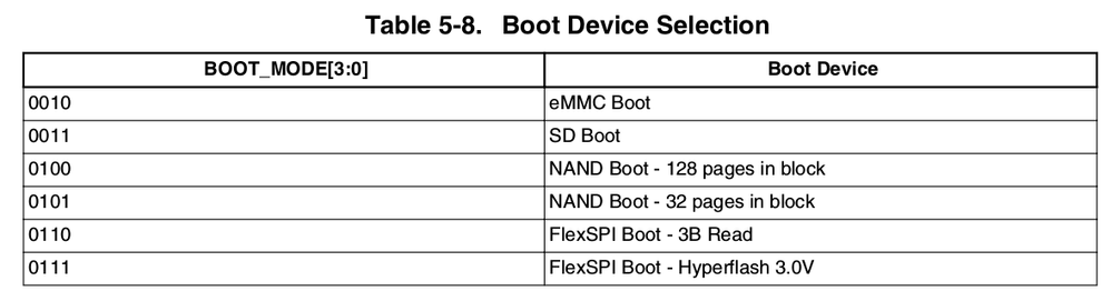

The i.MX8 can boot out of the following boot devices:
  • eMMC/SD card
  • FlexSPI Flash
  • NAND
  • Serial Download Protocol (USB) - This is used in manufacturing mode to bring-up a board by downloading an image to RAM and then flashing the on-board boot device.
The following table indicates the available options on a i.MX8QXP, the i.MX8 reads the boot mode pads and based in the configuration selects the desired boot device.

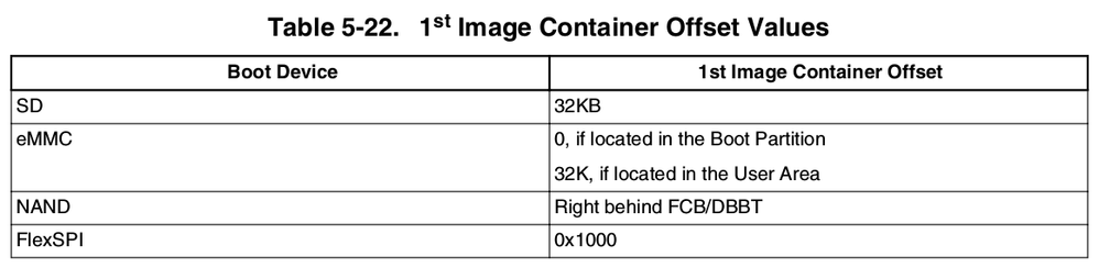

Once the boot device has been identified, ROM configures the boot media and attempts to read the image from a predefined address in the boot device, the following table shows the addresses where the image is expected to be on different boot devices.
ROM loads data from the predefined addresses above (depending on the selected boot device) to the System Controller Unit (SCU) internal memory (tightly coupled memory) and parses it to find the image container. It can also boot by downloading an image through USB.
The image container has all the information needed to load all the images to the system, the first images that get loaded are the System Controller Firmware (SCFW) and Security Controller Firmware (SECO).

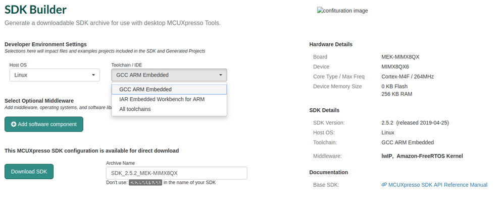

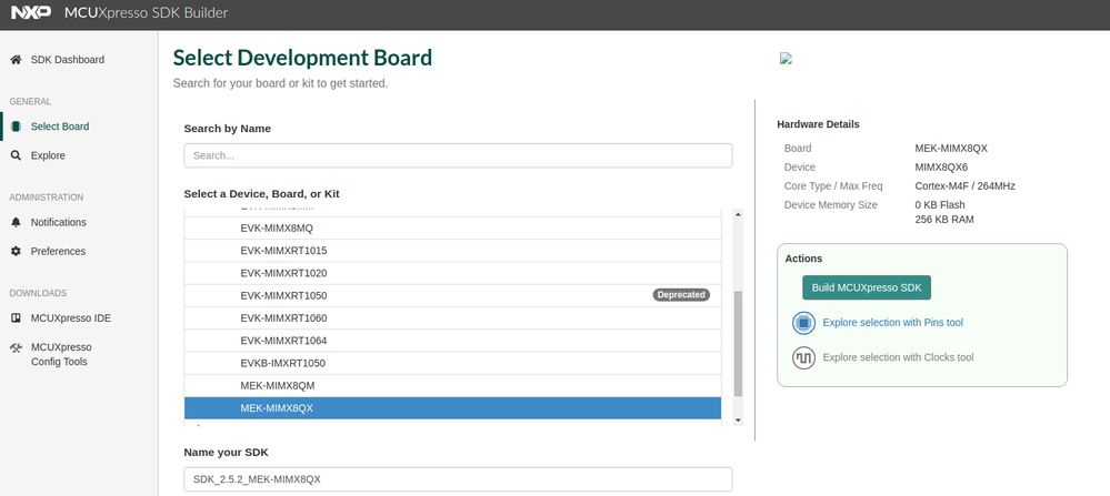

The image for the Cortex-M4 can be generated using the SDK:
https://mcuxpresso.nxp.com/en/select
Just select the device you are working with and click Build MCUXpresso SDK, then you will prompted to select your IDE and host.
Click on Download SDK and a compressed file containing the SDK will be dowloaded to your computer. Now you only need to uncompress the file and follow the steps in the getting started document to generate the image.
The getting started document includes steps to setup the toolchain and build an image for the M4.
An M4 binary for the QM and QXP MEKs is also attached in this document, the example outputs a hello world message on the M4 terminal.

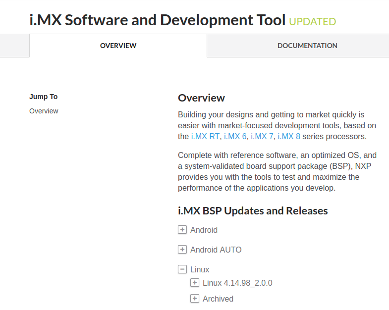

The bootloader for the Cortex-A cores can be obtained through the Yocto BSP:
The steps on generating the image for the 4.14.98 release can be found here:
https://www.nxp.com/webapp/Download?colCode=imx-yocto-L4.14.98_2.0.0_ga
Some more details on the Yocto BSP can be found here:
https://community.nxp.com/docs/DOC-94849

Remember from the information above that the i.MX8 will search for the image at 32k on the SD card, that is why we are flashing it there.
