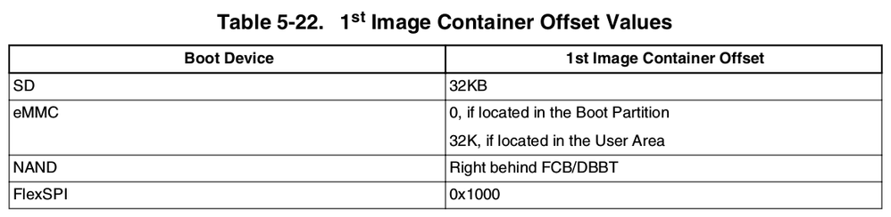

The following table indicates the available options on a i.MX8QXP, the i.MX8 reads the boot mode pads and based in the configuration selects the desired boot device.

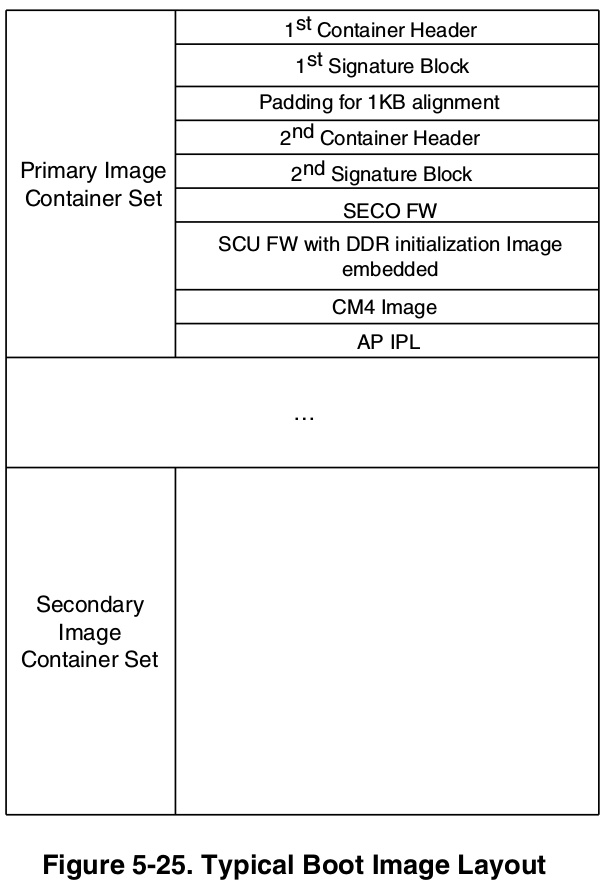

Once the boot device has been identified, ROM configures the boot media and attempts to read the image from a predefined address in the boot device, the following table shows the addresses where the image is expected to be on different boot devices.
ROM loads data from the predefined addresses above (depending on the selected boot device) to the System Controller Unit (SCU) internal memory (tightly coupled memory) and parses it to find the image container. It can also boot by downloading an image through USB.
The image container has all the information needed to load all the images to the system, the first images that get loaded are the System Controller Firmware (SCFW) and Security Controller Firmware (SECO).
The SECO FW needs to be loaded to refresh the watchdog timer (kick the dog) in the device, if the SECO FW is not loaded before the watchdog expires the device will reset, this usually happens when the device fails to fetch a valid image from the boot media.
Once the SCFW is loaded, ROM jumps to it and starts executing it.
The SCFW then initializes the DDR and starts loading the images for the Cortex-M4 (optional) and the Cortex-A cores (optional).
Once the images are loaded to their destination memory the SCFW boots the cores and sets them in their start address.

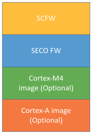

As a recap a bootable image is comprised of as minimum the System Controller Firmware and the Security Controller Firmware, optionally it can contain images for the Cortex M4 cores (if more than one available as in the case of QM devices) and Cortex A cores.
It is possible to boot an image that only contains the SCFW and SECO FW, this could be useful in the first stages of porting the SCFW to the target board. It is also possible to boot an image with only the Cortex-M4 image (baremetal, FreeRTOS, AutoSAR...), only the Cortex-A image (U-boot or any bootloader) or both Cortex-M4 and Cortex-A images.

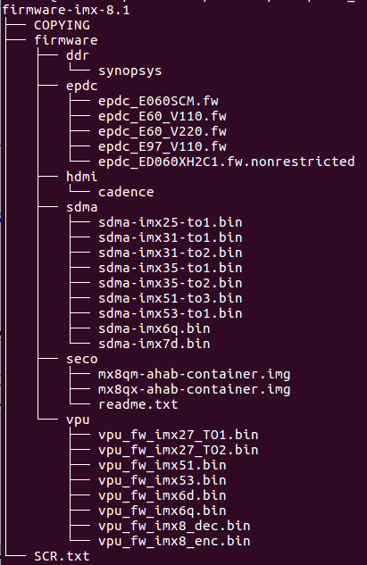

Getting the SECO FW
The Security Controller Firmware is only distributed in binary form and can be obtained from the NXP website.
Download SECO FW binaries for release 4.14.98_02 here.
chmod a+x firmware-imx-8.1.bin
./firmware-imx-8.1.bin‍‍‍‍‍‍‍‍‍‍
You will prompted to accept a license agreement and after that the binaries will be extracted:
The SECO FW is under firmware/seco
  • mx8qm-ahab-container.img -----> SECO FW for QM devices
  • mx8qx-ahab-container.img ------> SECO FW for QXP devices

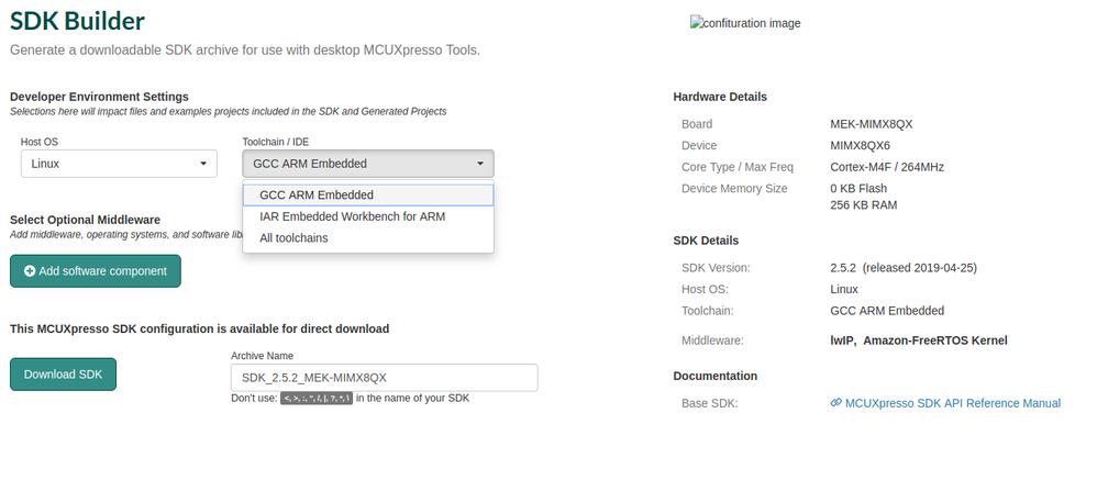

Getting an image for the Cortex-M4
The image for the Cortex-M4 can be generated using the SDK:
https://mcuxpresso.nxp.com/en/select
Just select the device you are working with and click Build MCUXpresso SDK, then you will prompted to select your IDE and host.
Click on Download SDK and a compressed file containing the SDK will be dowloaded to your computer. Now you only need to uncompress the file and follow the steps in the getting started document to generate the image.
The getting started document includes steps to setup the toolchain and build an image for the M4.
An M4 binary for the QM and QXP MEKs is also attached in this document, the example outputs a hello world message on the M4 terminal.

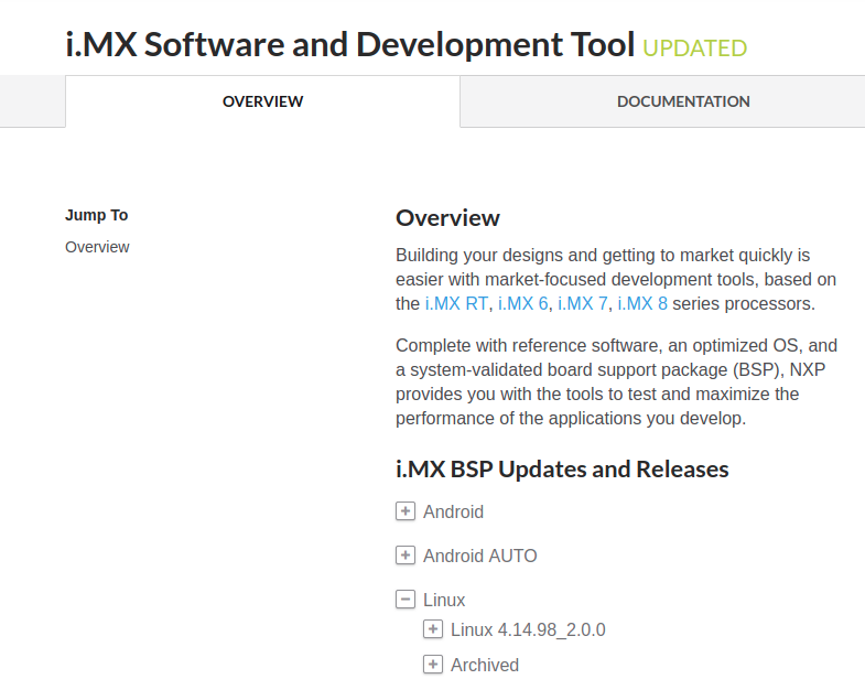

Getting an image for the Cortex-A
The bootloader for the Cortex-A cores can be obtained through the Yocto BSP:
The steps on generating the image for the 4.14.98 release can be found here:
https://www.nxp.com/webapp/Download?colCode=imx-yocto-L4.14.98_2.0.0_ga
Some more details on the Yocto BSP can be found here:
https://community.nxp.com/docs/DOC-94849

Remember from the information above that the i.MX8 will search for the image at 32k on the SD card, that is why we are flashing it there.
