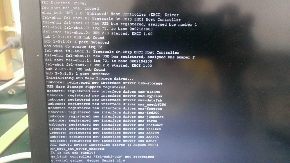

I have a problem about usb mass storage driver, that's it can't enumerate my mass storage device.
but it can enumerate my mouse, keyboard...etc hid device.
anyone have idea about it ?
I always get below messages when my mass storage device plugs in.
and below is my dmesg information
My hardware -->
Type A receptacle on otg controller ~

Hi Ken,
My issue had been fixed…but I didn’t do anything, that’s HW issue.

Maybe the difference between mass storage and HID devices is the speed.
Is this a custom board? Then check the layout and routing of the USB differential data lines.
Also, do you supply the USB PHY of the i.MX6 properly?
