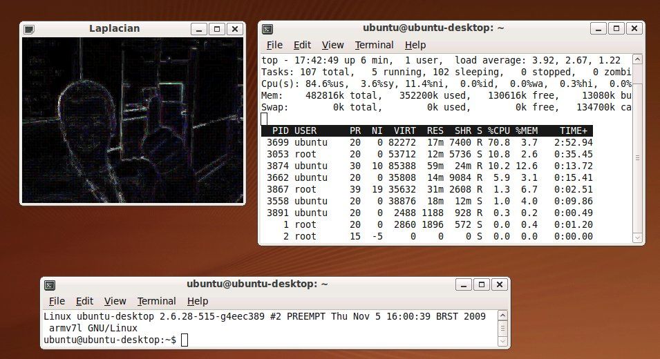

Installing OpenCV on i.MX 51 EVK Board running Ubuntu Linux
Assuming that you already have the Ubuntu Linux running on your board, you can use this wiki page to guide you to get your USB camera running on your system in order to use real time image processing features of this library.
In a brand new installation of Ubuntu some libraries is not installed by default, so you need to install them by your own hands (use synaptic to do that), here is the list of these libraries:
  1. libgtk2.0-dev
  2. libjpeg62-dev
  3. zlib1g-dev
  4. libpng12-dev
  5. libtiff4-dev
  6. libjasper-dev
  7. libgst-dev
  8. libgstreamer0.10-dev
If you already have some of those libraries installed, make sure that is the DEV version.
After installing those libraries you can download the stable OpenCV version here.
Install it following the procedure below:
1 - untar the opencv package
tar -xvzf opencv-1.1pre1.tar.gz
2 - change to OpenCV folder
cd opencv-1.1.0
3 - configure the installation enabling gstreamer and letting to compile demo apps later
./configure --with-gstreamer --disable-apps
You will get the following results:
General configuration ================================================
      Compiler:                         g++
      CXXFLAGS:
      DEF_CXXFLAGS:             -Wall -fno-rtti -pipe -O3 -fomit-frame-pointer
      PY_CXXFLAGS:               -Wall -pipe -O3 -fomit-frame-pointer
      OCT_CXXFLAGS:             -fno-strict-aliasing -Wall -Wno-uninitialized -pipe -O3 -fomit-frame-pointer
      Install path:                      /usr/local
HighGUI configuration ================================================
      Windowing system --------------
      Use Carbon / Mac OS X:        no
      Use gtk+ 2.x:                        yes
      Use gthread:                         yes
      Image I/O ---------------------
      Use ImageIO / Mac OS X:       no
      Use libjpeg:                            yes
      Use zlib:                                yes
      Use libpng:                             yes
      Use libtiff:                               yes
      Use libjasper:                          yes
      Use libIlmImf:                          no
      Video I/O ---------------------
      Use QuickTime / Mac OS X:     no
      Use xine:                                no
      Use gstreamer:                        yes
      Use ffmpeg:                             no
      Use dc1394 & raw1394:     no
      Use v4l:                                   yes
      Use v4l2:                                 yes
      Use unicap:                             no
Wrappers for other languages =========================================
      SWIG Python                          no
      Octave                                    no
Additional build settings ============================================
      Build demo apps                      no
Now run make ...
4 - Build OpenCV
./make
5 - Install OpenCV
./sudo make install
if all steps above were executed properly, now you can compile the sample applications:
1 - change to samples/c directory
cd samples/c
2 - change the build_all script mode to +x
chmod +x build_all.sh
3 - run the script
./build_all.sh
Now you can test. The results below were taken from the Laplacian filter sample processing in real-time images grabbed from an USB camera:
Laplacian filter with USB Camera capture device
Also, you can see how is it performance on a 3 windowed application performing color conversion and canny edge detection at the same time:
http://www.youtube.com/watch?v=w9yQgdABT7c
