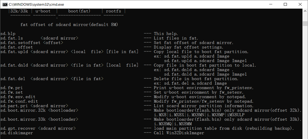

  • Under some situations, need to modify the binary image.
  • Under some situations, no development environment.
  • Under some situations, even no Linux. Only have windows.
  • Board bring up need simple settings, such as simple/tiny rootfs.
Key Features
  • Create small sdcard mirror image
  • All operations are on binary files no need development environment(offline)
  • Set the u-boot environment on binary image
  • Windows OS support
Snapshot:
