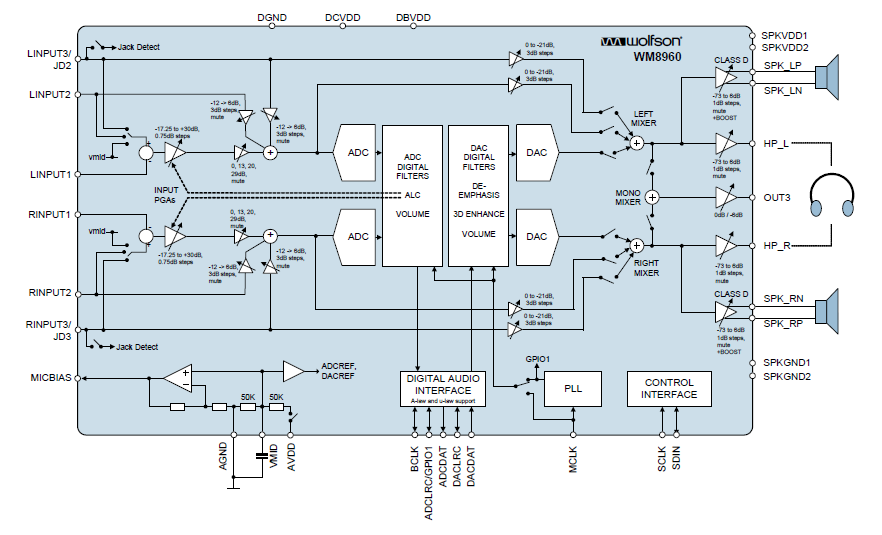

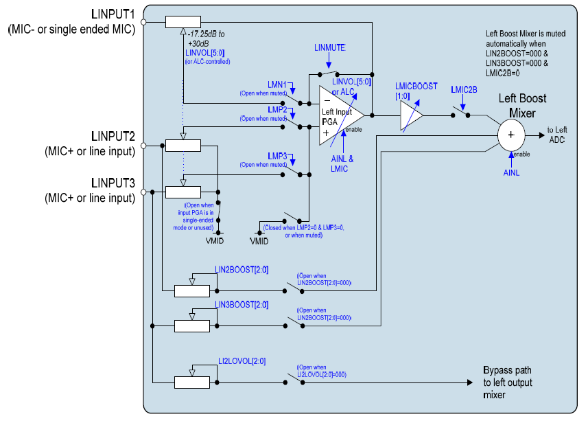

Audio controls and path in WM8960

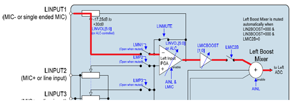

Left and Right Input signal path

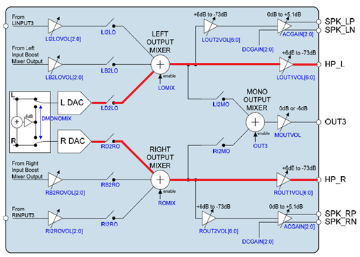

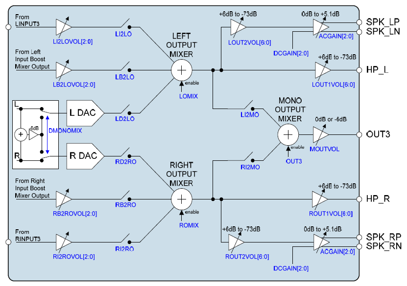

Output signal path
Base on the input and output signal diagrams, we can setup all the controls that we want in the driver. Such as switches, volume controls, PGA controls and so on. All the controls below can be used in the alsamixer.

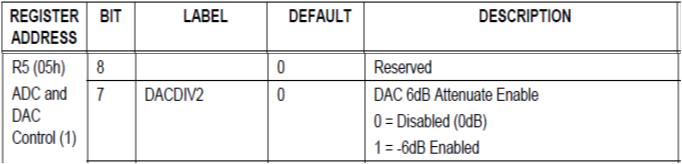

1. SOC_SINGLE(xname, reg, shift, max, invert)
To setup a simple switch, we can use SOC_SINGLE.
e.g
SOC_SINGLE("PCM Playback -6dB Switch", WM8960_DACCTL1, 7, 1, 0),
- The name of this control is “PCM Playback -6dB Switch”.
- The register in WM8960 is WM8960_DACCTL1 . (the register address is 0x5, defined in wm8960.h)
- ‘7’ : The 7th bit in DACCTL1 register is used to enable/disable the DAC 6dB Attenuate.
- ‘1’ : Only one enable or disable option.
- ‘0’ : the value you set is not inverted.

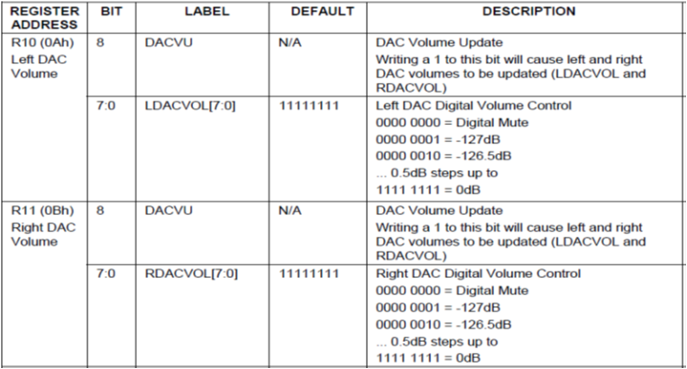

2. SOC_SINGLE_TLV(xname, reg, shift, max, invert, tlv_array)
To setup a switch with levels, we can use SOC_SINGLE_TLV.
e.g.
In this example, the left input volume control is from 000000(-17.25dB) to 111111(+30dB). Each step is 0.75dB. Total is 63 steps.
SOC_SINGLE_TLV("Input Volume of LINPUT1", WM8960_LINVOL, 0, 63, 0, in_tlv),
The scale of in_tlv declare like this:
static const DECLARE_TLV_DB_SCALE(in_tlv, -1725, 75, 0);
in_tlv : the name of the scale.
-1725 : start from -17.25dB
75: each step is 0.75dB
0: the step is start from 0. For some volume control case the first step is "mute", then the step is start from 1 so change this number to 1.
for example: The 0000 0000 of the DAC volume control is digital mute.
static const DECLARE_TLV_DB_SCALE(dac_tlv, -12700, 50, 1);

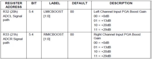

5. SOC_ENUM_SINGLE(xreg, xshift, xmax, xtexts)
When the control option are some texts, we can use SOC_ENUM to enum the options.
e.g. MIC boost
5.1. setup the array for the texts.
static const char *wm8960_micboost[] = {"0dB","+13dB","+20dB","+29dB"};
5.2. use the SOC_ENUM_SINGLE.
static const struct soc_enum wm8960_enum[] = {
     SOC_ENUM_SINGLE(WM8960_DACCTL1, 5, 4, wm8960_polarity),
     SOC_ENUM_SINGLE(WM8960_DACCTL2, 5, 4, wm8960_polarity),
     SOC_ENUM_SINGLE(WM8960_3D, 6, 2, wm8960_3d_upper_cutoff),
     SOC_ENUM_SINGLE(WM8960_3D, 5, 2, wm8960_3d_lower_cutoff),
     SOC_ENUM_SINGLE(WM8960_ALC1, 7, 4, wm8960_alcfunc),
     SOC_ENUM_SINGLE(WM8960_ALC3, 8, 2, wm8960_alcmode),
     SOC_ENUM_SINGLE(WM8960_LINPATH, 4, 4, wm8960_micboost),
     SOC_ENUM_SINGLE(WM8960_RINPATH, 4, 4, wm8960_micboost),
5.3.  use SOC_ENUM to add the controls for MIC boost.
SOC_ENUM("Capture Left Boost", wm8960_enum[6]),
SOC_ENUM("Capture Right Boost", wm8960_enum[7]),

static const struct snd_kcontrol_new wm8960_loutput_mixer[] = {
SOC_DAPM_SINGLE("<- LD2LO", WM8960_LOUTMIX, 8, 1, 0), //LD2LO
SOC_DAPM_SINGLE("<- LI2LO", WM8960_LOUTMIX, 7, 1, 0), //LI2LO
SOC_DAPM_SINGLE("<- LB2LO", WM8960_BYPASS1, 7, 1, 0), //LB2LO
static const struct snd_kcontrol_new wm8960_routput_mixer[] = {
SOC_DAPM_SINGLE("<- RD2RO", WM8960_ROUTMIX, 8, 1, 0), //RD2RO
SOC_DAPM_SINGLE("<- RI2RO", WM8960_ROUTMIX, 7, 1, 0), //RI2RO
SOC_DAPM_SINGLE("<- RB2RO", WM8960_BYPASS2, 7, 1, 0), //RB2RO
static const struct snd_kcontrol_new wm8960_mono_out[] = {
SOC_DAPM_SINGLE("<- L2MO", WM8960_MONOMIX1, 7, 1, 0), //L2MO
SOC_DAPM_SINGLE("<- R2MO", WM8960_MONOMIX2, 7, 1, 0), //R2MO

Now, we can start to route the audio path.
The path is from right to left , like : { “destination”, “switch”, “source” }
So, lets take the LINPUT1 to ADC as an example:
{ "Left Input PGA", "<- LMN1", "LINPUT1" },
{ "Left Boost Mixer", "<- LMIC2B", "Left Input PGA" },
{ "Left ADC", NULL, "Left Boost Mixer" },
Another example is DAC to Headphone.
                { "Left Output Mixer", "<- LD2LO", "Left DAC" },
                { "Right Output Mixer", "<- RD2RO", "Right DAC" },
                { "Left HP PGA", NULL, "Left Output Mixer" },
                { "Right HP PGA", NULL, "Right Output Mixer" },
                { "HP_L", NULL, "Left HP PGA" },
                { "HP_R", NULL, "Right HP PGA" },

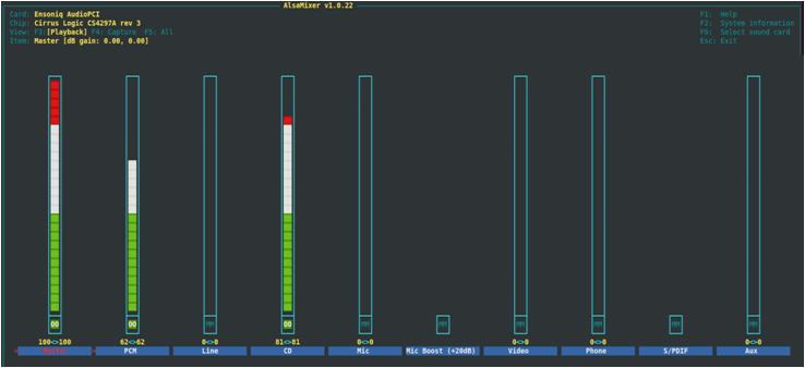

In linux, you can run "alsamixer" to turn on/off the switches and adjust the volumes.
(this picture is an example of alsamixer of other codec, not for wm8960)
In alsamixer, use 'M' to turn the switch on/off,  use arrow keys to control the volumes.

Please tell me, can I route audio paths in this codec accordingly to this scheme:
Mic1 (LINPUT1/2) directly to OUT3,
Line In (LINPUT3) directly to SPK_R,
Mic2 (RINPUT1/2) to CPU,
CPU to SPK_L.
"directly" means that sound passes through the codec with no help of CPU.
Is this configuration feasible?
Now I am able only to capture Mic1/2 with CPU and play captured sound.
