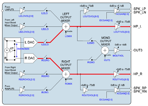

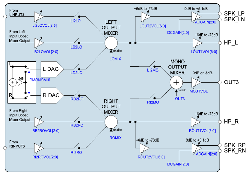

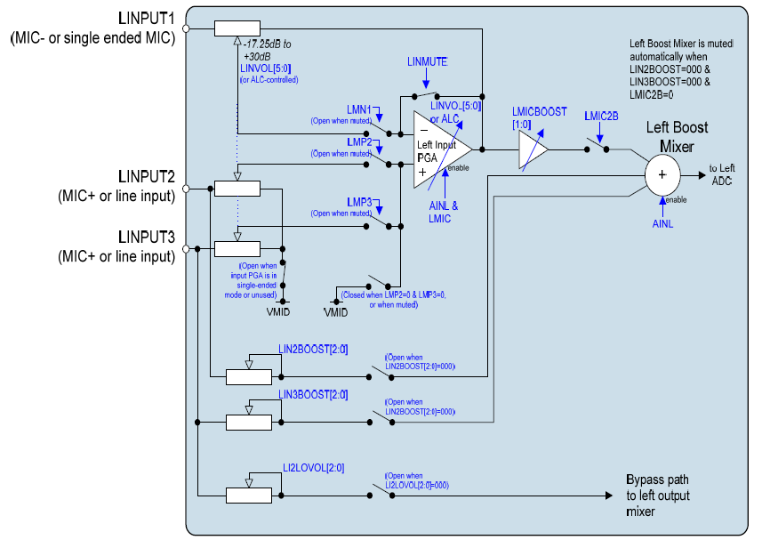

Audio controls and path in WM8960
Left and Right Input signal path
Output signal path
Base on the input and output signal diagrams, we can setup all the controls that we want in the driver. Such as switches, volume controls, PGA controls and so on. All the controls below can be used in the alsamixer.

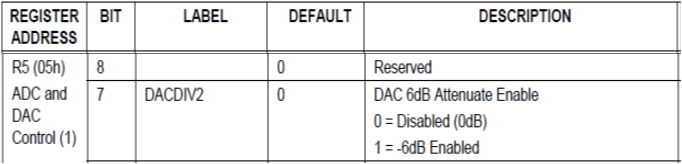

1. SOC_SINGLE(xname, reg, shift, max, invert)
To setup a simple switch, we can use SOC_SINGLE.
e.g
SOC_SINGLE("PCM Playback -6dB Switch", WM8960_DACCTL1, 7, 1, 0),
- The name of this control is “PCM Playback -6dB Switch”.
- The register in WM8960 is WM8960_DACCTL1 . (the register address is 0x5, defined in wm8960.h)
- ‘7’ : The 7th bit in DACCTL1 register is used to enable/disable the DAC 6dB Attenuate.
- ‘1’ : Only one enable or disable option.
- ‘0’ : the value you set is not inverted.

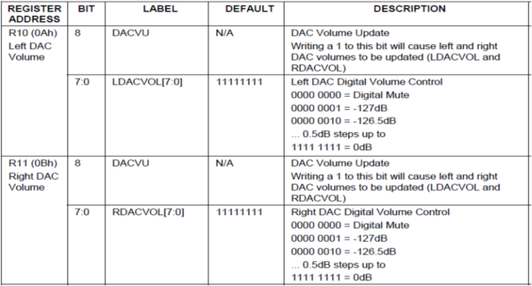

0: the step is start from 0. For some volume control case the first step is "mute", then the step is start from 1 so change this number to 1.
for example: The 0000 0000 of the DAC volume control is digital mute.
static const DECLARE_TLV_DB_SCALE(dac_tlv, -12700, 50, 1);

After created all the controls, we can start to create the switches.
The following switches created base on the input and output diagrams. I used the same name from datasheet of each switch. It will more easy to find out the proper switch in alsamixer.
static const struct snd_kcontrol_new wm8960_lin[] = {
SOC_DAPM_SINGLE("<- LMP2", WM8960_LINPATH, 6, 1, 0), //LMP2
SOC_DAPM_SINGLE("<- LMP3", WM8960_LINPATH, 7, 1, 0), //LMP3
SOC_DAPM_SINGLE("<- LMN1", WM8960_LINPATH, 8, 1, 0), //LMN1
static const struct snd_kcontrol_new wm8960_lin_boost[] = {
SOC_DAPM_SINGLE("<- LMIC2B", WM8960_LINPATH, 3, 1, 0), //LMIC2B
static const struct snd_kcontrol_new wm8960_rin[] = {
SOC_DAPM_SINGLE("<- RMP2", WM8960_RINPATH, 6, 1, 0), //RMP2
SOC_DAPM_SINGLE("<- RMP3", WM8960_RINPATH, 7, 1, 0), //RMP3
SOC_DAPM_SINGLE("<- RMN1", WM8960_RINPATH, 8, 1, 0), //RMN1
static const struct snd_kcontrol_new wm8960_rin_boost[] = {
SOC_DAPM_SINGLE("<- RMIC2B", WM8960_RINPATH, 3, 1, 0), //RMIC2B
static const struct snd_kcontrol_new wm8960_loutput_mixer[] = {
SOC_DAPM_SINGLE("<- LD2LO", WM8960_LOUTMIX, 8, 1, 0), //LD2LO
SOC_DAPM_SINGLE("<- LI2LO", WM8960_LOUTMIX, 7, 1, 0), //LI2LO
SOC_DAPM_SINGLE("<- LB2LO", WM8960_BYPASS1, 7, 1, 0), //LB2LO
static const struct snd_kcontrol_new wm8960_routput_mixer[] = {
SOC_DAPM_SINGLE("<- RD2RO", WM8960_ROUTMIX, 8, 1, 0), //RD2RO
SOC_DAPM_SINGLE("<- RI2RO", WM8960_ROUTMIX, 7, 1, 0), //RI2RO
SOC_DAPM_SINGLE("<- RB2RO", WM8960_BYPASS2, 7, 1, 0), //RB2RO
static const struct snd_kcontrol_new wm8960_mono_out[] = {
SOC_DAPM_SINGLE("<- L2MO", WM8960_MONOMIX1, 7, 1, 0), //L2MO
SOC_DAPM_SINGLE("<- R2MO", WM8960_MONOMIX2, 7, 1, 0), //R2MO

Now, we can start to route the audio path.
The path is from right to left , like : { “destination”, “switch”, “source” }
So, lets take the LINPUT1 to ADC as an example:
{ "Left Input PGA", "<- LMN1", "LINPUT1" },
{ "Left Boost Mixer", "<- LMIC2B", "Left Input PGA" },
{ "Left ADC", NULL, "Left Boost Mixer" },
Another example is DAC to Headphone.
                { "Left Output Mixer", "<- LD2LO", "Left DAC" },
                { "Right Output Mixer", "<- RD2RO", "Right DAC" },
                { "Left HP PGA", NULL, "Left Output Mixer" },
                { "Right HP PGA", NULL, "Right Output Mixer" },
                { "HP_L", NULL, "Left HP PGA" },
                { "HP_R", NULL, "Right HP PGA" },

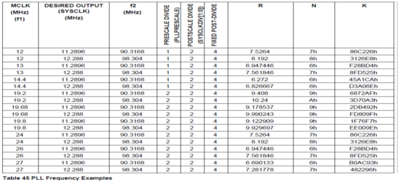

In the wm8960_set_dai_pll, we need to calculate the proper PLL values.
Base on the table, if the MCLK >14.4, the sysclk prescale divider is 2. So, set the sysclk pre-divider to 2 before finding pll_factors.
if (freq_in > 15000000 ) {
                                /* update sysclk div */
                                reg = snd_soc_read(codec, WM8960_CLOCK1) & 0x1f9;
                                snd_soc_write(codec, WM8960_CLOCK1, reg | 0x4);
                                clk_in = clk_in/2;
                if (freq_in && freq_out) {
                                ret = pll_factors(clk_in, freq_out, &pll_div);
                                if (ret != 0)
                                                return ret;

Please tell me, can I route audio paths in this codec accordingly to this scheme:
Mic1 (LINPUT1/2) directly to OUT3,
Line In (LINPUT3) directly to SPK_R,
Mic2 (RINPUT1/2) to CPU,
CPU to SPK_L.
"directly" means that sound passes through the codec with no help of CPU.
Is this configuration feasible?
Now I am able only to capture Mic1/2 with CPU and play captured sound.
