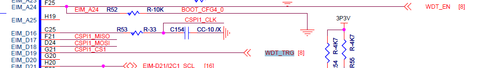

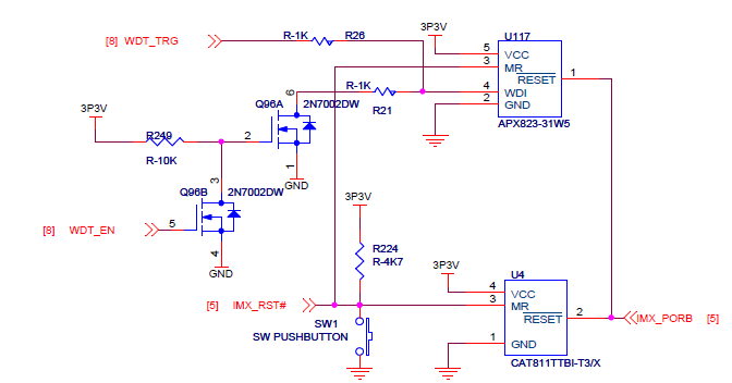

  • The UDOO board features an external watchdog that needs to be disabled with a GPIO, otherwise U-Boot resets after a few seconds:
         The WDOG pins need to be configured and in the mx6_udoo.c file a global struct configuration for those pins is declared, as well as macros for each pin
#define WDT_EN  IMX_GPIO_NR(5, 4)
#define WDT_TRG IMX_GPIO_NR(3, 19)
iomux_v3_cfg_t const wdog_pads[] = {
        MX6_PAD_EIM_A24__GPIO5_IO04 | MUX_PAD_CTRL(NO_PAD_CTRL),
        MX6_PAD_EIM_D19__GPIO3_IO19,
static void setup_iomux_wdog(void)
        imx_iomux_v3_setup_multiple_pads(wdog_pads, ARRAY_SIZE(wdog_pads));
        gpio_direction_output(WDT_TRG, 0);
        gpio_direction_output(WDT_EN, 1);
        gpio_direction_input(WDT_TRG);
This configuration needs to be called at some point of the board_early_init_f()
int board_early_init_f(void)
        setup_iomux_wdog();
        This way the board_early_init_f() calls the iomux for the external wdog and disables it.

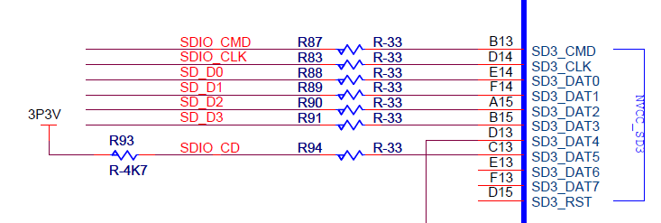

  • The UDOO board features only one micro SD slot to boot and U-Boot environment storage. It uses only 4 bits and it has to be configured too. In the include/configs/mx6_udoo.h file the USDHC module has to be defined and the MMC environment device.
#define CONFIG_SYS_FSL_USDHC_NUM   3
#define CONFIG_SYS_MMC_ENV_DEV       0     /* SDHC3 */
         The USDHC3 pin configuration has to be defined:
iomux_v3_cfg_t const usdhc3_pads[] = {
        MX6_PAD_SD3_CLK__SD3_CLK   | MUX_PAD_CTRL(USDHC_PAD_CTRL),
        MX6_PAD_SD3_CMD__SD3_CMD   | MUX_PAD_CTRL(USDHC_PAD_CTRL),
        MX6_PAD_SD3_DAT0__SD3_DATA0 | MUX_PAD_CTRL(USDHC_PAD_CTRL),
        MX6_PAD_SD3_DAT1__SD3_DATA1 | MUX_PAD_CTRL(USDHC_PAD_CTRL),
        MX6_PAD_SD3_DAT2__SD3_DATA2 | MUX_PAD_CTRL(USDHC_PAD_CTRL),
        MX6_PAD_SD3_DAT3__SD3_DATA3 | MUX_PAD_CTRL(USDHC_PAD_CTRL),
        MX6_PAD_NANDF_D0__GPIO2_IO00    | MUX_PAD_CTRL(NO_PAD_CTRL), /* CD */
struct fsl_esdhc_cfg usdhc_cfg[1] = {
        {USDHC3_BASE_ADDR, 0, 4},
This must be called and configured from the board_mmc_init() function:
int board_mmc_init(bd_t *bis)
        s32 status = 0;
        usdhc3_pads, ARRAY_SIZE(usdhc3_pads));
        usdhc_cfg[0].sdhc_clk = mxc_get_clock(MXC_ESDHC3_CLK);
                status |= fsl_esdhc_initialize(bis, &usdhc_cfg[0]);
        return status;

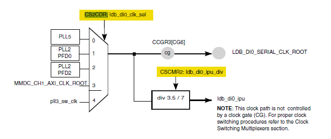

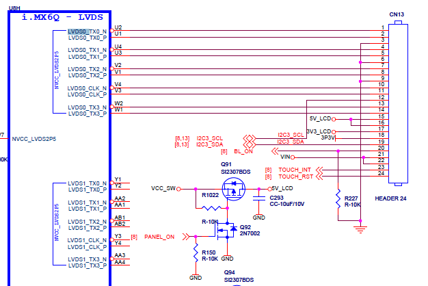

     The mx6_udoo.c file contains a setup_display function that configures the LDB module. This functions is called in the board_early_init_f(). With the current clock configuration is not possible to get  the 33.2MHz for the LVDS and a different clock source for the LDB module must be chosen. The backlight and lvds power signals must be on.
          The current configuration uses the mmdc_ch1 clock and to get closer to 33.26MHz the PLL2_PFD0 is chosen.
       gpio_direction_output(IMX_GPIO_NR(1, 2), 1); /* LVDS power On */
        gpio_direction_output(IMX_GPIO_NR(1, 4), 1); /* LVDS backlight On */
        imx_iomux_v3_setup_multiple_pads(di0_pads, ARRAY_SIZE(di0_pads));
        enable_ipu_clock();
        imx_setup_hdmi();
        /* Turn on4LDB0, LDB1, IPU,IPU DI0 clocks */
        reg = readl(&mxc_ccm->CCGR3);
        reg |=  MXC_CCM_CCGR3_LDB_DI0_MASK | MXC_CCM_CCGR3_LDB_DI1_MASK;
        writel(reg, &mxc_ccm->CCGR3);
        /* set LDB0, LDB1 clk select to 011/011 */
        reg = readl(&mxc_ccm->cs2cdr);
        reg &= ~(MXC_CCM_CS2CDR_LDB_DI0_CLK_SEL_MASK
                 | MXC_CCM_CS2CDR_LDB_DI1_CLK_SEL_MASK);
        reg |= (1 << MXC_CCM_CS2CDR_LDB_DI0_CLK_SEL_OFFSET)
              | (1 << MXC_CCM_CS2CDR_LDB_DI1_CLK_SEL_OFFSET);
        writel(reg, &mxc_ccm->cs2cdr);

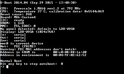

5. TESTING YOUR CHANGES
Inser the sd with the U-Boot image to micro sd slot and power up the board. You should get the U-Boot serial console like shown below.
In the console you can test the ethernet and phy configuration with the PING command:

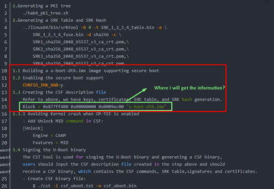

Can you give the solution for below screenshots
