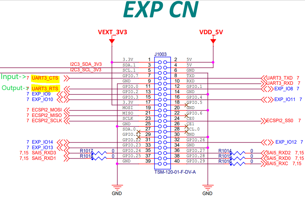

     The following steps allow you to toggle a pin on i.MX 8M Mini EVK, you can use the EVK as not gate, trigger a wake up signal, etc. With an script and modifying the device tree you can read an input and get as output the invert input.

In this example we are using the pin "UART3_CTS" like an input and "UART3_RTS" like an output.
To toggle the pin, run the script:
./toggle.sh
