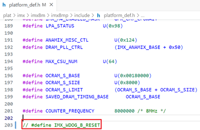

Customer find we have enabled all configs about pstore and ramoops, but they can't get ramoops log in /sys/fs/pstore node on Android 13.
Solution
The default reboot will reset all hardware including the DDR control, so this will result in the loss of the log stored in RAM.
We have include such codes in ATF, the default code will use imx_wdog_restart(true) to reset all hardware.
void __dead2 imx_system_reset(void)
#ifdef IMX_WDOG_B_RESET
	imx_wdog_restart(true);
#else
	imx_wdog_restart(false);
#endif
To avoid DDR reset, we should comment  IMX_WDOG_B_RESET in vendor/nxp-opensource/arm-trusted-firmware/plat/imx/imx8m/imx8mp/include/platform_def.h
Result
evk_8mp:/sys/fs/pstore # ls
console-ramoops-0  dmesg-ramoops-0  pmsg-ramoops-0
