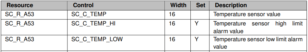

The control list looks as follows:
The table lists the controls available per resource as well as the width of the data to get/set, the 'Set' column describes whether a control is 'settable' or not, for instance the temperature sensor on the A53 resource can only be read/retrieved it cannot be 'written' (set) therefore the 'Y' (yes) in this column is missing, a brief description of the control is also provided.
To get a control sc_misc_get_control must be called:
uint32_t val;
sc_misc_get_control(ipc, SC_R_A53, SC_C_TEMP, &val)‍;‍‍‍‍‍‍
By default all calls to get_control need a pointer to a 32 bit unsigned integer, the width field on the control list table defines the span of meaningful data. In the example above the data from the temperature sensor in the A53 resource is retrieved. This call returns SC_ERR_NONE whenever it succeeds. If the parameters are invalid it returns SC_PARM and if the caller does not have access to that resource it returns SC_ERR_NOACCESS.
