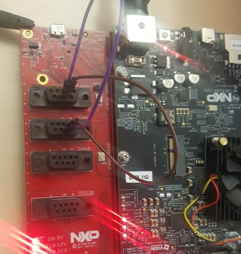

Now you can do a bridge between CAN0 and CAN1 on the board. The easiest way is to put simple wires (pin 2 to pin 2 a,d pin 7 to pin 7), normally you have to twist your wires, but as it is on your desk, you can get rid of it):

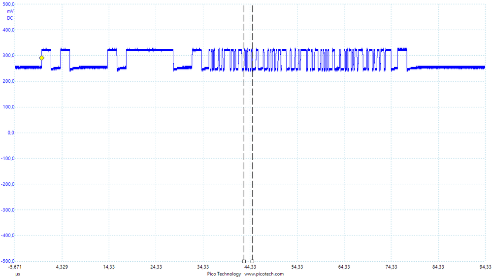

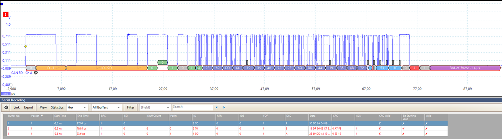

You can check with a scope your CAN FD frame (here CAN High):
And you can see the first part of the frame sent @500kps and the second part @4Mbps.
If you unplug one wire, the messages will no longer be sent as no acknowlege will occurs.

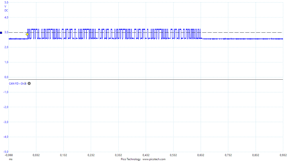

I have tried with a scope and I don't see RTR error:
I have errors but it is certainly due to the measure (long wires, oscilloscope frequency, etc...).
So please check you Vector tool supports CAN FD.
V.
