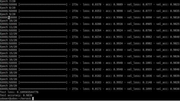

Test 2:
Be aware this test take some time (~1hr on udoo dual):
$ curl -sSL -k https://github.com/fchollet/keras/raw/master/examples/mnist_mlp.py | python
Output:

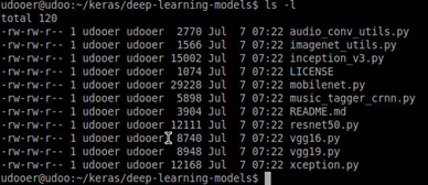

$ cd keras
$ git clone https://github.com/fchollet/deep-learning-models
$ Cd deep-learning-models
$ ls -l
Notice how we have four Python files. The resnet50.py , vgg16.py , and vgg19.py  files correspond to their respective network architecture definitions. The imagenet_utils  file, as the name suggests, contains a couple helper functions that allow us to prepare images for classification as well as obtain the final class label predictions from the network
