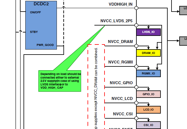

Question:
What does it means by depending on load? Is there a value?
This is  related with i.MX6D
Answer:
The comment about the "load" means the total system load on the 2.5V rail. We understand that people design systems, not just MX6 devices. The documentation confusion stems from the design team changing from allowing customers to use the LDOs to power system devices back to just using the LDOs to power the MX6. Reasons - thermals, and also concern for uncontrolled system noise injection into the MX6 and causing failures.
