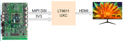

Here is the block diagram of LT9611UXC Demo Board.

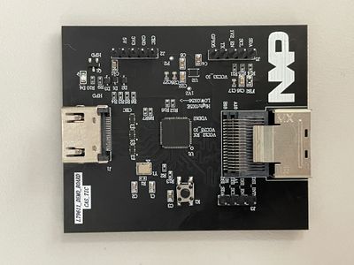

As the MIPI port of our EVK can provide 5V, 3V3 and 1V8.We can remove useless DC-DC chips from reference design.
Below is the LT9611UXC Demo Board.
