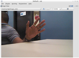

3. Testing The Installation

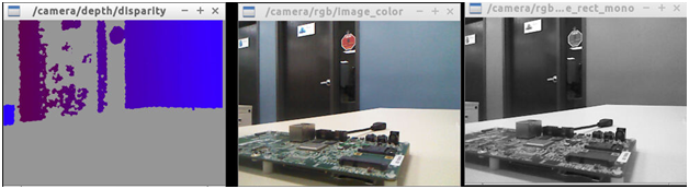

  1. Kinect. Open at least 3 bash terminals:
Terminal 1: Run ROS
$ roscore
Terminal 2:  launch the Freenect
$ roslaunch freenect_launch freenect.launch
Terminal 3: run the image capture
$ rosrun image_view image_view image:=camera/rgb/image_color
or:
$ rosrun image_view image_view image:=camera/rgb/image_rect_mono
or:
$ rosrun image_view disparity_view image:=camera/depth/disparity
It will open a new terminal with the rgb points, mono  and depth images  from the Kinect.

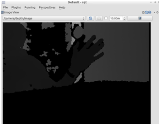

Xtion.
Terminal 1: Run ROS
$ roscore
Terminal 2:  launch Openni2
$ roslaun openi2_launch openni2.launch
Terminal 3: you can use rqt or Rviz session to visualize the sensor e.g:
$ rqt
or
$ rosrun rqt_graph rqt_graph
In the “rqt” window select “Plugins” -> “Visualization” -> “Image View“
