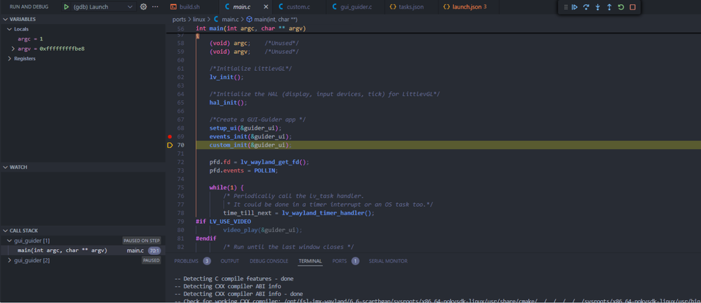

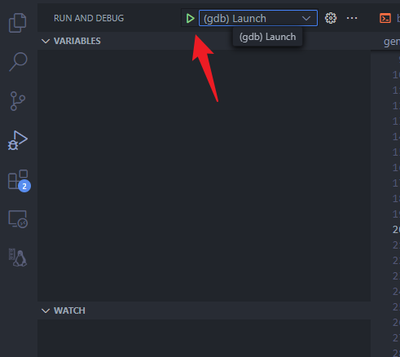

3. Debug in VSCode
Click (gdb)launch, the source code will be compiled.
Then you will see the breakpoint in program.
Enjoy your debug~
