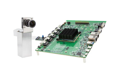

In this article, I will explain how to set up the iMX8M Plus to use the 4K Dart BCON Basler Camera module.
Requirements:
- Evaluation Kit for the i.MX 8M Plus Applications Processor. (i.MX 8M Plus Evaluation Kit | NXP Semiconductors)
- Basler Camera for i.MX 8M Plus (4K dart BCON for MIPI camera module for i.MX 8M Plus | NXP Semiconductors).
- Embedded Linux for i.MX Applications Processors (Embedded Linux for i.MX Applications Processors | NXP Semiconductors) (For this example we will use BSP version Linux 5.15.71_2.2.0)
- Serial Console Emulator
Basler Camera Specifications and Manuals:
- Basler Camera Specifications at this link: Embedded Vision Kits daA3840-30mc-IMX8MP-EVK - Embedded Vision Kits (baslerweb.com).
- Basler Manual to identify and setting up the hardware at this link: daA3840-30mc-IMX8MP-EVK | Basler Product Documentation (baslerweb.com)
- Basler Camera Module out-of-box with i.MX 8M Plus Applications Processor. (Video: Basler Camera Module out-of-box with i.MX 8M Plus Applications Processor | NXP Semiconductors)
Steps
After setting up the hardware we will need to turn on the iMX8M Plus and follow these steps:

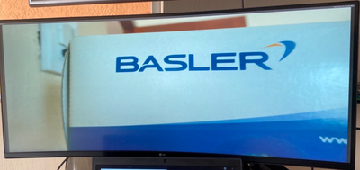

9. Finally, use gstreamer to verify proper operation. (With this gstreamer pipeline you will see a new window with the camera output. Then, just rotate the lens to acquire the correct focus)
$ gst-launch-1.0 -v v4l2src device=/dev/video2 ! "video/x-raw,format=YUY2,width=1920,height=1080" ! queue ! imxvideoconvert_g2d ! waylandsink

10. Result
