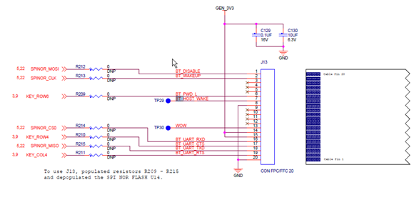

Hardware Changes
i.MX 6Dual/Quad SabreSD board doesn't enable Bluetooth connection by default. To support bluetooth, the hardware rework is required.
The above diagram shows the reserved connections for Bluetooth in SabreSD RevC board (All connections are marked as "DNP"). This Bluetooth cable connector is designed specifically for the WiFi/BT combo card SX-SDCAN-2830BT which is developed and sold by Silex Technology. Note that pin 1 (BT_DISABLE) of the cable connector on i.MX 6Dual/Quad SabreSD RevC is opposite Pin 20 of the WiFi/BT module. Note: when connecting Silex module and J13, the connection is reverted (For example, PIN 1 in J13 connects to PIN 20 in Silex module). To use the J13 connector, the following reworks are required:

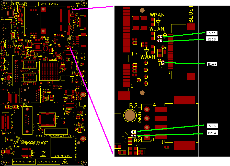

  •   R209-R211, R214-R215 need to be populated.
          Where is them, you can refer to the below chart.

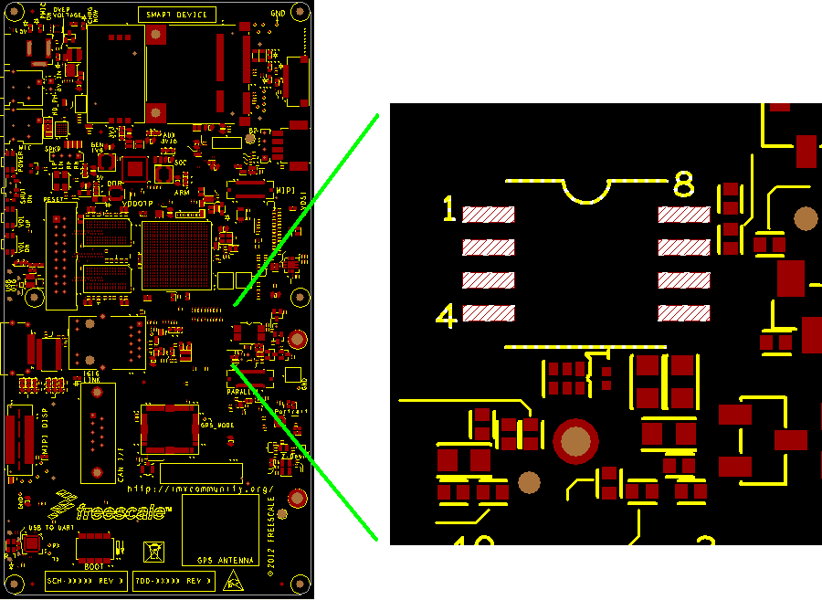

  • SPI nor flash U14 need to be depopulated.
  • No other AUX boards should be connected..

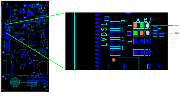

  • Exchange UART5_RXD and UART5_TXD.
Orange PAD connects to Orange PAD.
Green PAD connects to Green PAD.
   After hardware rework, the Bluetooth connection will like the following:
Pin on Silex ModuleSabresd BoardMux Pad
Pin-2  BT_UART_RTS  (output)UART5.RTS   (input)MX6Q_PAD_KEY_COL4__UART5_RTS
Pin-3  BT_UART_TXD   (output)UART5.RXD   (input)MX6Q_PAD_KEY_ROW1__UART5_RXD
Pin-4  BT_UART_CTS   (input)UART5.CTS   (output)MX6Q_PAD_KEY_ROW4__UART5_CTS
Pin-5  BT_UART_RXD   (input)UART5.TXD   (output)MX6Q_PAD_KEY_COL1__UART5_TXD
Pin-14  BT_PWD_L       (input)GPIO_2         (output)MX6Q_PAD_GPIO_2__GPIO_1_2
