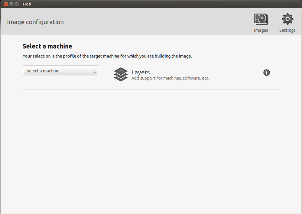

The GUI should then appear:

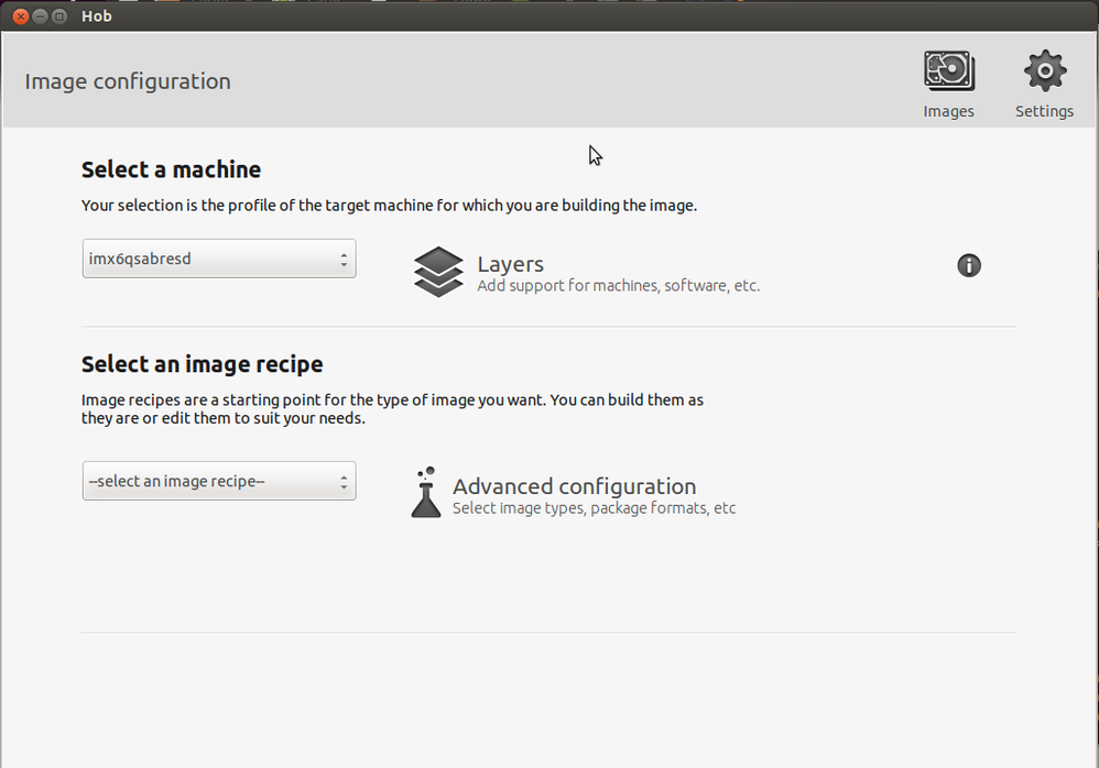

You may then select the MACHINE for which you will build and the Layers of your project. HOB  will take and updated the local.conf and bblayers.conf values so the desired BSP layers will already be selected and available MACHINES on these layers will appear on the drop down menu.
Once these options are set HOB will parse the recipes and create a dependency tree in order to show available images for that MACHINE.

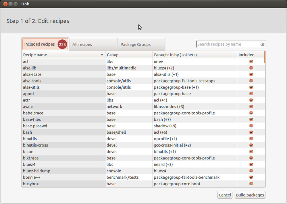

Recipes screen
On the recipes screen we can see the recipes included on the image and available recipes, then also package groups.
