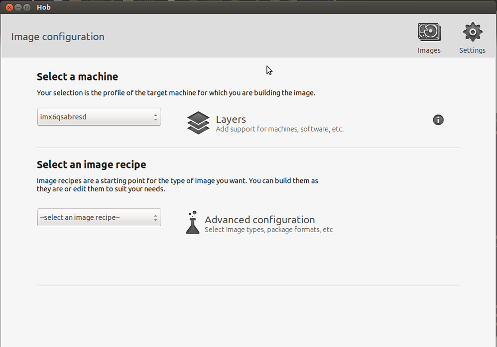

$ hob &
The GUI should then appear:

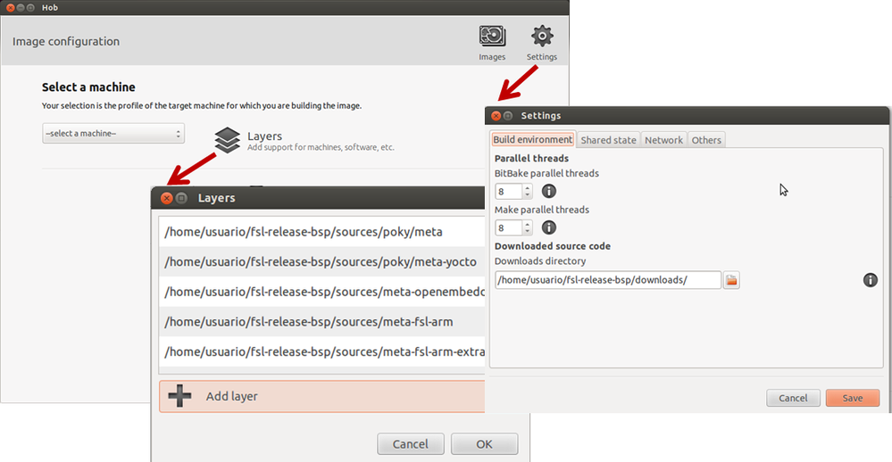

You may then select the MACHINE for which you will build and the Layers of your project. HOB  will take and updated the local.conf and bblayers.conf values so the desired BSP layers will already be selected and available MACHINES on these layers will appear on the drop down menu.
Once these options are set HOB will parse the recipes and create a dependency tree in order to show available images for that MACHINE.

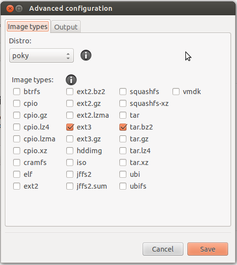

Image File System Types
Advance configuration options include image file system types. Please note that HOB does not support the sdcard format so if it is needed it has to be added manually on the local.conf file and then run bitbake outside of HOB. As HOB changed the local.conf file even if the sdcard format was originally available it may be rewrite and no longer available until the following line is added to local.conf.
IMAGE_FSTYPES="tar.bz2 ext3 sdcard"
