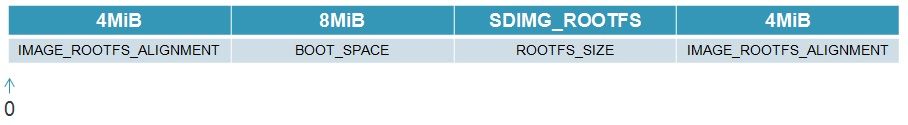

Partitions used on the .sdcard file
The .sdcard partitions looks as follow:
IMAGE_ROOTFS_ALIGNMENT
Unpartitioned space reserved for the bootloader
BOOT_SPACE
Kernerl and other data
ROOTFS_SIZE
The rootfs.
