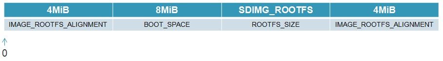

The .sdcard format creates an image with all necessary partitions and loads the bootloader, kernel and rootfs to this image. You can just low level copy the data on this file to the SD card device using dd as on the following command example:
$ sudo dd if=<image name>.sdcard of=/dev/sd<partition> bs=1M && sync
Partitions used on the .sdcard file
The .sdcard partitions looks as follow:
IMAGE_ROOTFS_ALIGNMENT
Unpartitioned space reserved for the bootloader
BOOT_SPACE
Kernerl and other data
ROOTFS_SIZE
The rootfs.
