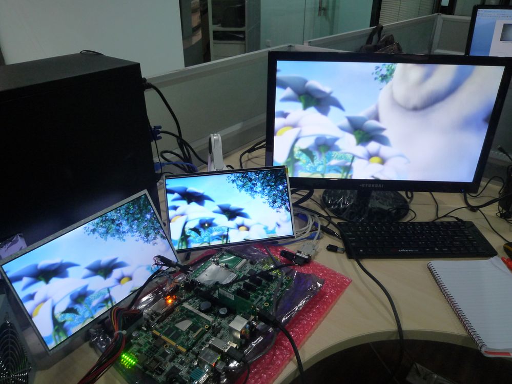

Multiple-Display means video playback on multiple screens. In case playback needs to be in a unique screen, the mfw_isink element must be used and some pipelines examples can be found on this link: GStreamer iMX6 Multi-Overlay.
Number of DisplaysDisplay typeKernel parameters
Pipelines
# Set these shells variables before running the pipelines
alias gl=gst-launch
SINK_1="\"mfw_v4lsink device=/dev/video17\""
SINK_2="\"mfw_v4lsink device=/dev/video18\""
SINK_3="\"mfw_v4lsink device=/dev/video20\""
media1=file:///root/media1
media2=file:///root/media2
media3=file:///root/media3
2hdmi + lvds
video=mxcfb0:dev=hdmi,1920x1080M@60,if=RGB24
video=mxcfb1:dev=ldb,LDB-XGA,if=RGB666
gl playbin2 uri=$media1 video-sink=$SINK_1 playbin2 uri=$media2 video-sink=$SINK_2
2lvds + lvds
video=mxcfb0:dev=ldb,LDB-XGA,if=RGB666
2lcd + lvds
video=mxcfb0:dev=lcd,800x480M@55,if=RGB565
3
hdmi + lvds + lvds
video=mxcfb2:dev=ldb,LDB-XGA,if=RGB666
gl playbin2 uri=$media1 video-sink=$SINK_1 playbin2 uri=$media2 video-sink=$SINK_2 playbin2 uri=$media3 video-sink=$SINK_3
