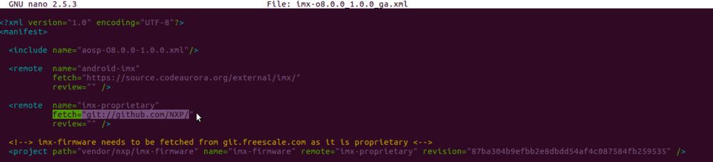

2) Find and edit the Android Manifest.
Once inside the build directory after synching, enter the repo manifests directory by executing the following command while inside the android build directory
$ cd .repo/manifests
 And look for the corresponding Android manifest. In this case imx-o8.0.0_1.0.0_ga.xml
Open this file in any text editor (use sudo if running in a directory which requires it) In this case we’ll exemplify with nano
$nano imx-o8.0.0_1.0.0_ga.xml
And change the git://git.freescale.com/proprietary/  to git://github.com/NXP/
Also the path for imx-firmware so the complete line goes from:
<project path="vendor/nxp/imx-firmware" name="imx-firmware" remote="imx-proprietary" revision="87ba304b9efbb2e8dbdd54af4c087584fb259535" />‍‍
To the following:
<project path="imx-firmware" name="imx-firmware" remote="imx-proprietary" revision="87ba304b9efbb2e8dbdd54af4c087584fb259535" />‍‍
The manifest should look like the following. Save the file with these changes.
Now you can run the imx_android_setup.sh build script successfully. Since the repo was already synced it won’t fetch the manifests again and the change we made will persist, which will allow to find the imx-firmware package on its new location.
