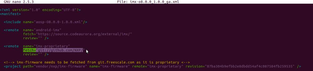

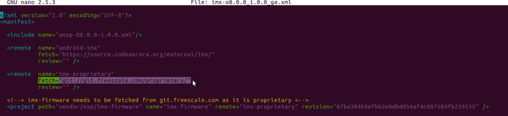

And change the git://git.freescale.com/proprietary/  to git://github.com/NXP/
Also the path for imx-firmware so the complete line goes from:
<project path="vendor/nxp/imx-firmware" name="imx-firmware" remote="imx-proprietary" revision="87ba304b9efbb2e8dbdd54af4c087584fb259535" />‍‍
To the following:
<project path="imx-firmware" name="imx-firmware" remote="imx-proprietary" revision="87ba304b9efbb2e8dbdd54af4c087584fb259535" />‍‍
The manifest should look like the following. Save the file with these changes.
Now you can run the imx_android_setup.sh build script successfully. Since the repo was already synced it won’t fetch the manifests again and the change we made will persist, which will allow to find the imx-firmware package on its new location.
