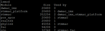

  5. Create the tar.gz file for flash the android image (*.img, *.bat, *.sh, *.bin, *.imx)
  6. Boot the image and type lsmod to ensure the drivers are installed.mario_castaneda_0-1719280397418.pngmario_castaneda_0-1719280397418.png
