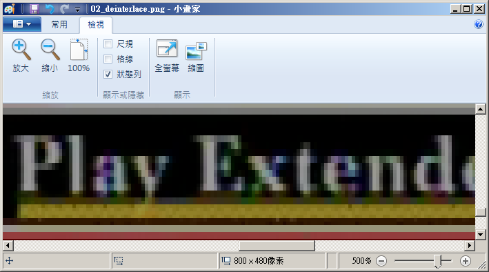

We found the VDI deinterlacing algorithms weren't good for video with small-font text in the video as it tends to blur or remove whole lines. Instead using deinterlacing in the CSI -> MEM channel works well for our needs (see ILO and Stride settings in CPMEM) however this requires substantial changes to the drivers.
BSP: L3.0.35_4.0.0
CVBS PAL/NTSC video is input to Video decoder ADV7180, and ADV7180 connect to I.MX6Q CSI BT656.
The de-interlace is set, but the quality is not good. Please check the picture attached.

Can this patch work in android 4.3?
m_c
Add apply patch, the image became blur. Is this right? How to improve it?
01_original = Freescale Android JB4.3 1.1.0
After apply deinterlance patch
