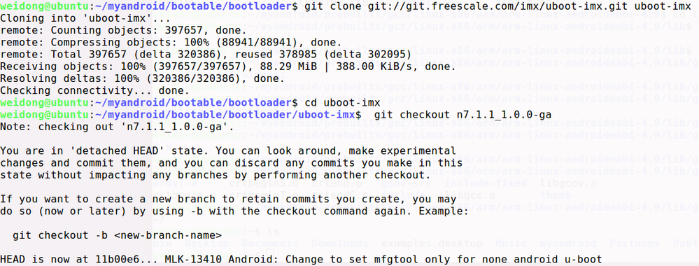

3.2 Getting uboot source code
$ cd ~/myandroid/bootable
$ mkdir bootloader
$ cd bootloader
$ git clone git://git.freescale.com/imx/uboot-imx.git uboot-imx
$ cd uboot-imx
$ git checkout n7.1.1_1.0.0-ga
