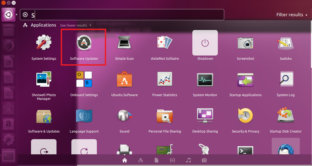

1. Running software updater to update system
      Customer can download ubuntu‐16.04.2‐desktop‐amd64.iso from
https://www.ubuntu.com/download/desktop
Then install it to VMware workstation player v12 or PC, after finishing installation, use
“Software Updater” to update system.
