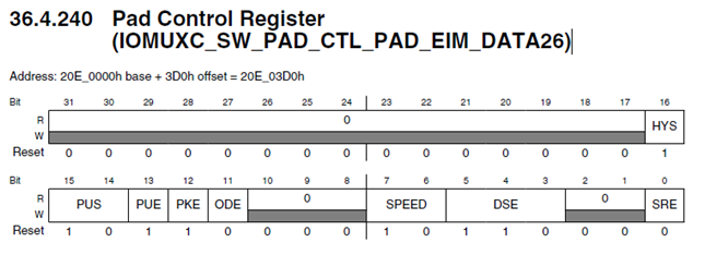

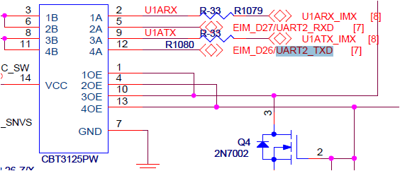

    • Add the pinctrl configurations for the nodes you want to add. UART2_TXD and UART2_RXD are the pins used for the serial debug console. The pin description must be placed in the iomuxc node.
&iomuxc{
     imx6q-udoo{
          pinctrl_uart2: uart2grp{
               fsl,pins = <
                         MX6QDL_PAD_EIM_D26__UART2_TX_DATA          0x1b0b1
                         MX6QDL_PAD_EIM_D27__UART2_RX_DATA          0x1b0b1

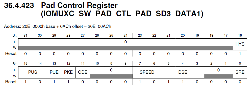

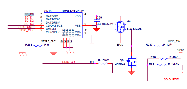

    • The RGMII connection and SD characteristics are the same as iMX6Q SABRE-SD .
pinctrl_usdhc3: usdhc3grp {
                        fsl,pins = <
                               MX6QDL_PAD_SD3_CMD__SD3_CMD 0x17059
                               MX6QDL_PAD_SD3_CLK__SD3_CLK 0x10059
                               MX6QDL_PAD_SD3_DAT0__SD3_DATA0 0x17059
                               MX6QDL_PAD_SD3_DAT1__SD3_DATA1 0x17059
                               MX6QDL_PAD_SD3_DAT2__SD3_DATA2 0x17059
                               MX6QDL_PAD_SD3_DAT3__SD3_DATA3 0x17059

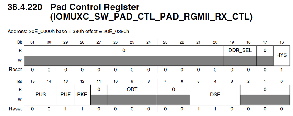

pinctrl_enet: enetgrp {
                        fsl,pins = <
                               MX6QDL_PAD_RGMII_RXC__RGMII_RXC 0x1b0b0
                               MX6QDL_PAD_RGMII_RD0__RGMII_RD0 0x1b0b0
                               MX6QDL_PAD_RGMII_RD1__RGMII_RD1 0x1b0b0
                               MX6QDL_PAD_RGMII_RD2__RGMII_RD2 0x1b0b0
                               MX6QDL_PAD_RGMII_RD3__RGMII_RD3 0x1b0b0
                               MX6QDL_PAD_RGMII_RX_CTL__RGMII_RX_CTL 0x1b0b0
                               MX6QDL_PAD_RGMII_TXC__RGMII_TXC 0x1b0b0
                               MX6QDL_PAD_RGMII_TD0__RGMII_TD0 0x1b0b0
                               MX6QDL_PAD_RGMII_TD1__RGMII_TD1 0x1b0b0
                               MX6QDL_PAD_RGMII_TD2__RGMII_TD2 0x1b0b0
                               MX6QDL_PAD_RGMII_TD3__RGMII_TD3 0x1b0b0
                               MX6QDL_PAD_RGMII_TX_CTL__RGMII_TX_CTL 0x1b0b0
                               MX6QDL_PAD_ENET_REF_CLK__ENET_TX_CLK 0x1b0b0
                               MX6QDL_PAD_ENET_MDIO__ENET_MDIO 0x1b0b0
                               MX6QDL_PAD_ENET_MDC__ENET_MDC 0x1b0b0
                               MX6QDL_PAD_GPIO_16__ENET_REF_CLK 0x4001b0a8

&usdhc3 {
        pinctrl-names = "default";
        pinctrl-0 = <&pinctrl_usdhc3>;
        non-removable;
        status = "okay";
