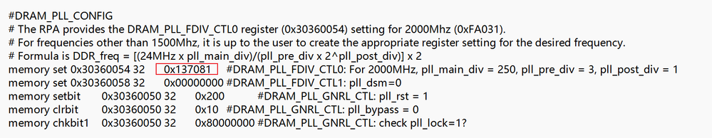

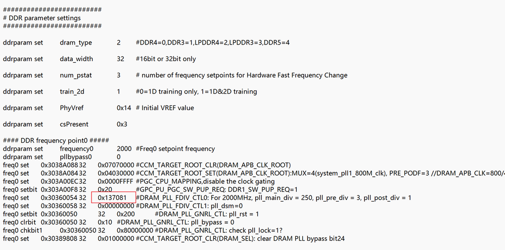

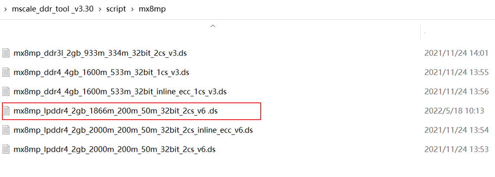

2.1 Creating a test script for 1866MHz
Here we copy the script from another file (e.g. 2000MHz) and modify the contents of the script.
UmiCrGJNSlwEjZD
2.2 Modify the script to adapt to 1866MHz
mMBhQZqsXItExWb
2CLDIHet8qJbnSu

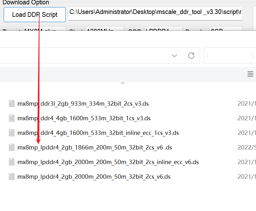

2.3 Download the test script
After selecting the ddr script we created, click on the download button
kCXU2R4YDxP5Fqp

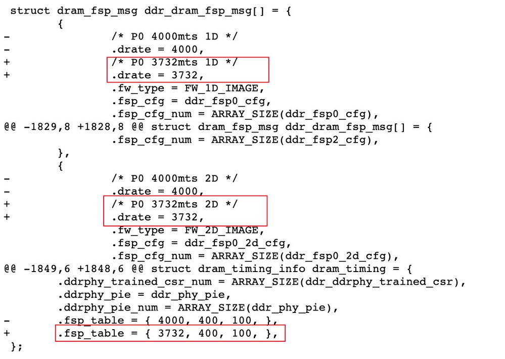

2.5 Modify lpddr4_timing.c
We need to modify the generated lpddr4_timing.c file to change the maximum speed to 3732MTS.

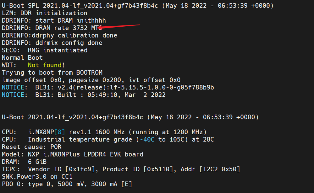

4. Test results
1tiJu2A8P4qNeQB
