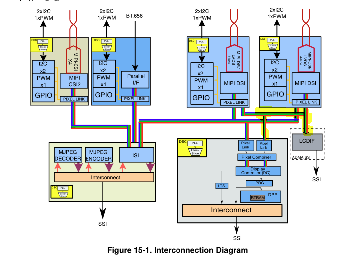

Im trying to connect the display controller output to the eLCDIF interface in the ADMA subsystem.
The block diagram in section 15.1.1.1 of the reference manual shows a possible connection using the pixel link, but provides no further information.
I have looked at the SDK examples for the i.MX8 but there are noone provided for the eLCDIF interface.
Furthermore the SDK examples for the DPU also dont show how outputting to the eLCDIF interface would be done,  only how to select one of the two lvds channels.
How could I set about to acomplish this? As far as I can tell the so called "pixel link" is a AXI bus, which means there should be a axi master (LCDIF) which I would have to connect with an axi slave (the pixel link of the dc?).
Thanks in advance.

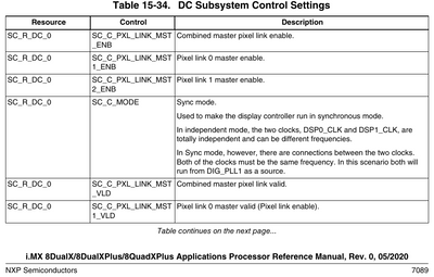

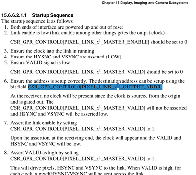

Pixel link is dedicated bus used for transferring pixel between master (DISPLAY ) and slave (with fix address. )
The address the master is sending to is configured though SCU FW call.
The document "sc_fw_api_qx_b0.pdf" part of the imx-scfw-porting-kit is describing the API:
That's what the following chapter is trying to explain in the RM:
But I would have expected to be find it in the RM chapter:
Verification on the errata: nothing is preventing to to configure the pixel address.
But looking at the latest internal documentation, it feels like the feature has been de-scoped

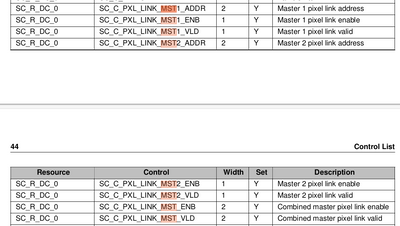

I'm am still unsure on which value to write to the SC_C_PXL_LINK_MST1_ADDR resource, if I want to use the eLCDIF interface as an output.
Looking at the dpu_character SDK example, it seems like this value is always 0 for LVDS or DSI, the only difference is the DPU display index.
Do I need to take additional steps to output to the eLCDIF or is there a simple address I need to use for the SC_C_PXL_LINK_MST1_ADDR resource?

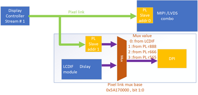

Rita_Wang
Pixel link slave address will be 1.
Additional "pixel link mux" should be configured at 0x5A170000
(personal drawing, this is not coming from any documentation.)
Even if the address is described as "reserved", it controls the pixel link mux internal to the LCDIF module.
There might be requirement for the clocking that I still need to clarify.
If I understood correctly the slice of the LCDIF should be configured to use the bypass input when using the Pixel link input.

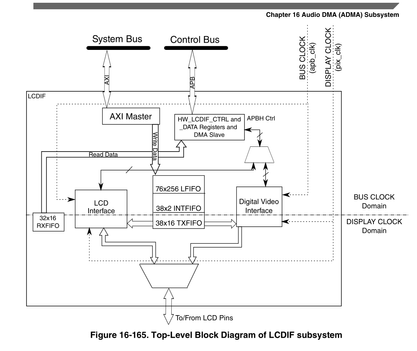

How do I need to configure the eLCDIF display module? Your drawing makes it look like the module is bypassed altogheter, and changing *0x5A170000 = 1/2/3 is all I need to do.
Looking at the eLCDIF subsystem overview:Unbenannt.PNGUnbenannt.PNG
It still seems like I still have to configure the LCD Interface to drive the LCD pins. Do I have to configure the eLCDIF Interface to be in e.g. DOTCLK mode? Looking at the startup sequence of the pixel link, I still need to power on the reciever (the lcdif mux, which I have not found the right resource for).
Is there some documentation on this lcdif mux that I can get my hands on? As far as I can see its not documented in the eLCDIF chapter or the pixel link chapter. Its rather frustrating having to wait for your answers, instead of looking up things myself.
