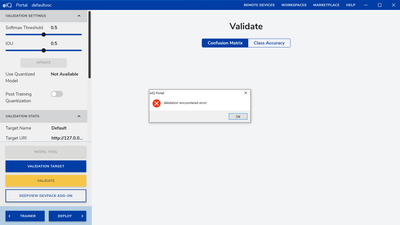

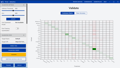

Hi Team,
We have trained a object detection model using updated eIQ portal 2.2.14.When trying to validate the model, we are facing the following error.
Trace: ShowError -> {"type":"error","message":"Validation encountered error: "}
    at N (C:\nxp\eIQ_Toolkit_v1.1.8\resources\app.asar\background.js:1:105046)
    at IpcMainImpl.<anonymous> (C:\nxp\eIQ_Toolkit_v1.1.8\resources\app.asar\background.js:1:110550)
    at IpcMainImpl.emit (events.js:327:22)
    at Object.<anonymous> (electron/js2c/browser_init.js:161:9692)
    at Object.emit (events.js:315:20)
Error Details -> undefined
Error Details -> "An error occured while converting model"
And also when tried to export the model, similar kind of error occurs. This happens only when trying to export model as rtm file. but not in other formats.
Trace: ShowError -> {"type":"error","message":"Failed to convert model:"}
Error Details -> "TypeError: Failed to fetch"
I'm attaching a sample deepview project link: defaultvoc.deepview .You can recreate the issue by just training for 1 epoch and try to validate it and export it.
Does anyone have any intuition why this error is happening?

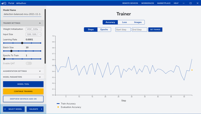

This download link works fine, thanks. What model did you train on the dataset? When I tried using the "Object Detection > Balanced > MCU" and trained it for one epoch, the validation worked fine. Are you using a custom model? Can you share the model plugin file for eIQ Portal as well?

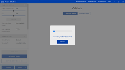

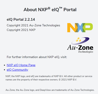

Interesting. I'm not able to reproduce the error with your project. I tried it with the performance model settings but validation still works fine for me. I noticed your UI has a small difference to mine:
- you have only 5 options on the slider whereas I have 6. Are you sure you are using the eIQ Portal v2.2.14 (eIQ Toolkit v1.1.8) version of the tool?
Can you describe the exact steps you take from opening the project you shared to getting the error? I just open the project, choose the model, don't change any settings whatsoever, let the model train for one epoch and then validate it and it works.

yes im using v2.2.14 only.

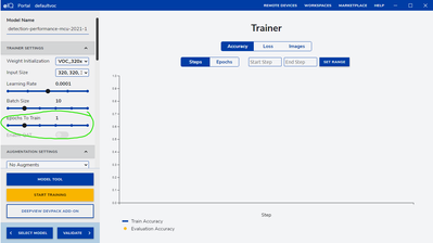

Steps :
1. open the project
2. Select model -> Detection - > Performance -> MCU
3. Set batch size to 64
4. Set Default Augmentation - Oriented
5. Set Scale = small, Activation = relu6, Optimizer = Adam

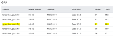

 I have installed CUDA version 11.2.2 and cuDNN version 8.1.1 which was mentioned in the Tensorflow guide.
What version of CUDA and cuDNN version do you use?
