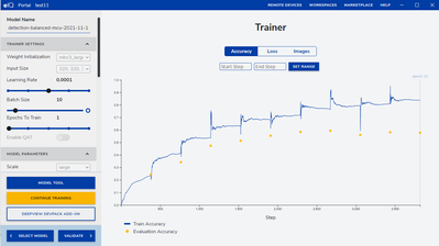

jonmg
My intention in this moment is to learn about the eIQ Tool and not so much about achieving a very good model so I stopped after 10 Epochs achieving a 0.83% accuracy as seen in the image bellow. I think you should be able to open my training status as I also sent you the model training checkpoints.

david_piskula
I see, thank you. I just wanted to confirm that the dataset can be used to train a model with a somewhat useful accuracy. The accuracy rises very slowly in the v1.0.5 so I wanted to know if it actually keeps getting better over a long time period or not. Seems like it works fine, so that's good.
