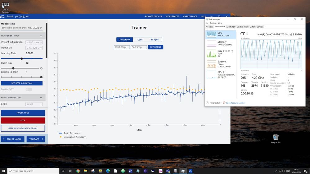

Hello Team,
When using eIQ portal, the CPU utilization is reaching 100% which causes system crash regularly. So I couldn't run the training continuously.
I do have a GeForce RTX 2060 GPU with CUDA 11.2.66 drivers installed as well. , but as you can see in the below image, the GPU utilization is almost 0%.
My System Details are as follows:
Proccessor - Intel(R) Core(TM) i7-8700 CPU @3.20GHz, 3192 Mhz.
RAM - 16 GB
GPU - Nvidia GeForce RTX 2060
OS Name : Microsoft Windows 10 Pro
I couldn't find any documents explaining the system requirements and enabling GPU utilization for running eIQ portal. Please provide any information regarding this.
Thanks in Advance,
Ramson Jehu K

david_piskula
Hello @Ramson,
are you still encountering the crashes when using the tool? Could you please provide me with the check log for inspection? You can find it in %AppData% -> Roaming\eIQ Portal\logs\main.log
As for the issue with TensorFlow, have you been able to solve it? I'm afrad I won't be able to help with TensorFlow build errors if even Google didn't understand your issue.
David

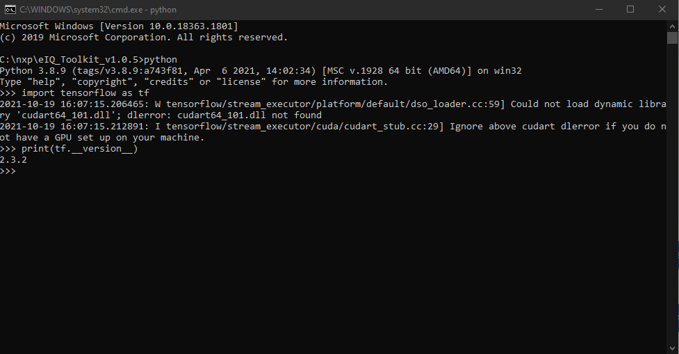

david_piskula
Hi @Ramson,
you don't have to build TF from source. eIQ Portal comes preinstalled with TensorFlow. You can check the version by opening the command line from eIQ Portal and using the following commands:

david_piskula
Hello @Ramson,
thank you for your interest in eIQ Portal. I will need to report this issue to the development team. Could you please also provide more information about your dataset (either what it is exactly, if it's publicly available, or at least image size and dataset size) and the exact software version you are using? You can find the version in Help -> About eIQ Portal.
David

Ramson
Hi @david_piskula ,
We are using VOC dataset, which is mentioned in this Au-zone's video: https://youtu.be/gbaeK8hUdHA .
The eIQ Portal Version is 2.1.30.
Can you provide details about system requirements and how to enable GPU utilization?

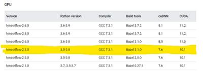

david_piskula
Hello @Ramson,
the Cuda driver version depends on the TensorFlow version supported by eIQ Portal. In the currently released eIQ Portal, the TensorFlow version is 2.3.2.
Please try installing the v7.6 cuDNN and CUDA 10.2 and let me know if that helps with enabling the training on your GPU.
https://www.tensorflow.org/install/source#gpu
David

Ramson
Hi @david_piskula ,
I have been struggling for the past few days building TF v2.3.2 with CUDA 10.2 and v7.6 cuDNN. I'm facing the following issue.
external/com_google_absl\absl/time/clock.h(70): error C2065: 'Duration': undeclared identifier
external/com_google_absl\absl/time/clock.h(70): error C2146: syntax error: missing ')' before identifier 'duration' external/com_google_absl\absl/time/clock.h(70): error C2143: syntax error: missing ';' before '{'
external/com_google_absl\absl/time/clock.h(70): error C2447: '{': missing function header (old-style formal list?) Target
//tensorflow/tools/pip_package:build_pip_package failed to build INFO: Elapsed time: 899.084s, Critical Path: 504.33s INFO: 1352 processes: 1352 local. FAILED: Build did NOT complete successfully
I have also posted this in Tensorflow github : https://github.com/tensorflow/tensorflow/issues/52092 .
Please help if have came across this error before while building.
