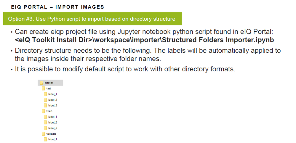

We are trying to create eiq project using own dataset with the help of instruction given in TP-EIQ-BRING-YOUR-OWN-DATA-BYOD document as shown below.
We created a python script as mentioned in the notebook as shown below :

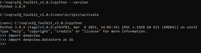

Hello!I have used what you adviced in your answer.But my computer still says that there's no module named 'deepview'.How can I sovle this problem?I downloaded eIQ Tookit from the official web.Should I uninstall the eIQ and install it again?I haven't installed any pip pack named 'deepview' because I can't find it on the Internet....Thank you in advance for answering my stupid question!
Here's a picture as attachments.Maybe it can describle my question better.

thanks @MarcinChelminsk . I did try that before, since i had other python installed. It caused me this problem. I removed other python and conda installed.

MarcinChelminsk
@Ramson
Before eIQ toolkit installation I had Python379 installed on my system, and after eIQ Toolkit installation (which comes with Python389) I had no conflicts.
Perhaps, as you mentioned, existing Python versions might be important and conda installation as well.
