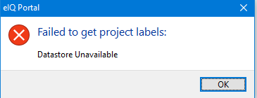

  5. when I hit particular image and give him a label (`full image label` option) and click right arrow to go to next image I get almost every time error such as:Capture.PNG

5) We'll get that fixed in the next update.
