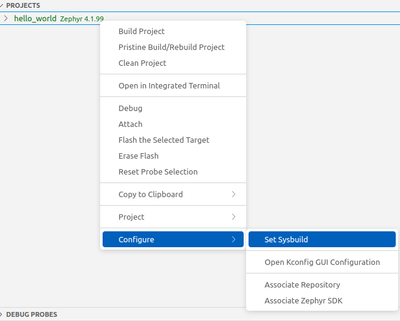

To enable Sysbuild for this project, start in the Projects view, right-click on the project, click the Configure menu, and click "Set Sysbuild".
A pop-up appears in the center of the top of the VS Code window.  Select the Enable option. To learn more, see Configuring Sysbuild in VS Code.

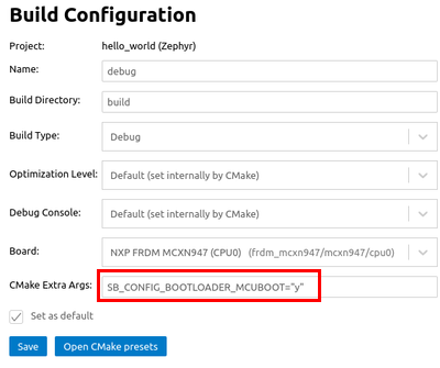

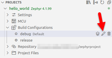

We also want to configure the app to build for MCUboot by setting the Cmake variable SB_CONFIG_BOOTLOADER_MCUBOOT=y.  To configure Cmake variables, Expand the project, and expand the Build Configurations.  Select the build configuration to edit, and click the pencil icon on the right.  Here we are editing the default "debug" configuration for the hello_world project.
In the field CMake Extra Args, add SB_CONFIG_BOOTLOADER_MCUBOOT="y" and CONFIG_BUILD_OUTPUT_HEX="y", then click Save. To learn more, see Cmake Variables in VS Code.

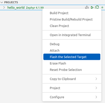

Debugging the app will not program the MCUboot image to the flash.  But we can flash either image to the board using VS Code.  In the Projects view, right-click the project and select Flash the Selected Target.

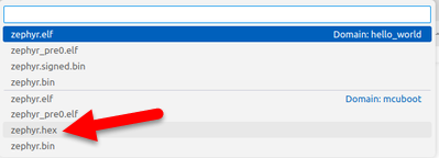

In the pop-up at the top of the window, select the zephyr.hex file in Domain: mcuboot.  VS Code will flash that zephyr.hex file to the board.
Now you we can debug or flash the app.
