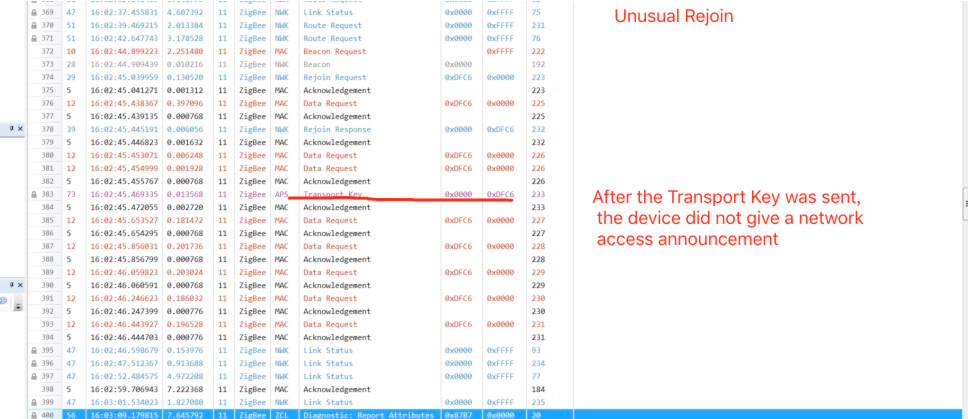

I want to ask a question about the  Rejoin of zigbee devices. I use JN5169 zigbee3.0. The device is a HA door sensor, and there is only one door sensor in the gateway.
After the gateway is powered off for a period of time, the door sensor will become an orphan node, and then Rejoin the network every 16 minutes.
The gateway is powered off first. After the door sensor becomes an orphan node,  Power on the gateway.  The door sensor start Rejoin the network (the distance between the gateway and the door sensor is very close), but the first Rejoin is basically unsuccessful, and It takes more than two times to Rejoin the network successfully. two screenshots of the packet capture are attached. Can you help me see it?

The ZPS_eAplZdoTransportNwkKey will also reset the frame counter on the target node(s). I am not sure if the frame counter could be the issue, please look at the ZPS_tsAplApsKeyDescriptorEntry
Please look at the C. Implementation of Frame Counters. It could help you to understand the frame counter implementation.

This is a good way, thanks! But we think that our door sensor sensor cannot REJOIN in time because the value of the APS frame counter is incorrect after power off and restart.
Where can I modify the APS frame counter when transmitting the Transport Key, or how to modify the initial value of the APS frame counter when the gateway is powered on again.

wangqi
Hi! This is because the gateway's FrameCounter is smaller than the device's. You can try adding FrameCounter when the gateway starts up.
