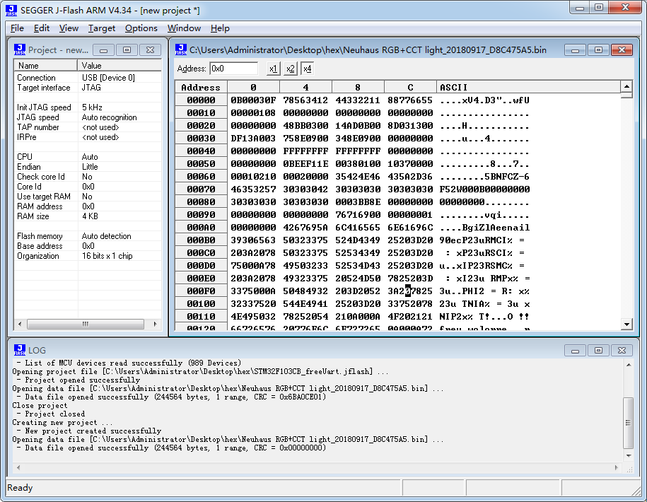

my question:
1.   I had flash erase successful,but when I download bin file to jn516x(use Message Type 0x09)cannot success.I missed any step
2. I see the project (JN-AN-1222-ZB-IoT-Gateway Host-with-NFC\Source\Host\openWrt\packages\NXP\iot_gw\src\jnFlasher\jennicProgrammer\  )
this project use message type 0x09 download bin file and use message type 0x1D write arm. I can't understand how it decide 0x1D 4byte addr. I can't file this addr.
 message type 0x1D in (chip jn5169) first send:
FE 1D 00 04 00 04 0A 14 2A 54 00 00 02 04 CC F0 7F 01 6C E7 31 34 E7 F8 3C 07 90 47 25 80 3C 07 D0 47 22 80 3C 07 10 38 60 FC 98 E0 FF FF 00 00 64 63 3A 0E 80 38 60 FF 47 D2 48 88 C0 90 F0 00 20 38 E0 FF D3 06 60 A0 84 C0 50 F0 00 20 00 E8 6C 63 60 60 E6 3A 3E 07 38 8C 60 21 00 00 80 60 E0 3D 00 C6 6C E7 F9 80 00 50 F0 00 20 8C C0 01 00 00 80 8C C0 47 F0 00 80 94 C6 00 00 00 08 40 06 2F 98 C0 00 00 00 08 8C C0 17 F0 00 80 8C 00 29 00 00 80 04 67 47 D2 48 CC F0 7A 01 34 E7 E0 41 03 88 84 C0 50 F0 00 20 00 D8 80 C0 50 F0 00 20 90 C7 00 20 00 20 3C 07 C0 24 C6 00 84 60 50 F0 00 20 98 E0 00 80 80 00 64 E7 02 60 60 1D 6C 63 F9 8C C0 29 00 00 80 8C E0 09 00 00 80 47 D2 48 6C 63 60 08 83 38 E0 10 8C 80 21 00 00 80 8C E0 01 00 00 80 00 E0 0C 20 8C 60 71 00 00 70 08 1F 00 04 00 04 F8 00 EF
addr is 04000400   but my bin file is
why addr is 0x0400400

By any chance, have you tried using the Flash programmer available in the  ZigBee 3.0|NXP  page ?
You can find more information regarding it, in the following link.
