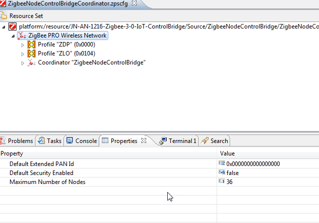

hi,
i want to create a zigbee network with 300-500s nodes, it should be a tree network. And i do not want too many routers in the net. Can somebody help me any message to make it.
thanks a lot.

I recommend the JN-AN-1216 Control Bridge, This example provide a coordinator example and tool that you can send a command to one of the devices, recognize if this is a router or end device. You can set the maximum nodes that you want.
Note: If you limit the routers that you want, the coordinator will increase the end devices table and the memory will be short and not enough for all the end devices.
Then, a simple example Please take a look at the JN-AN-1217. It provides a router and an end device template.
ZigBee 3.0|NXP
Another option could be theIEEE 802.15.4 for JN516x and JN517x|NXP  without all the Zigbee stack.
Please let me know if you have more questions.

i am trying AN-1229 to do the work. but there was a lot tables, how can i made a better config? i am not very clear the relationship between the tables.
