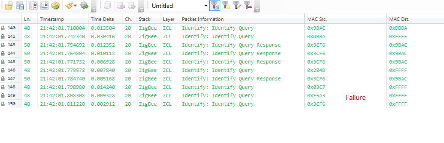

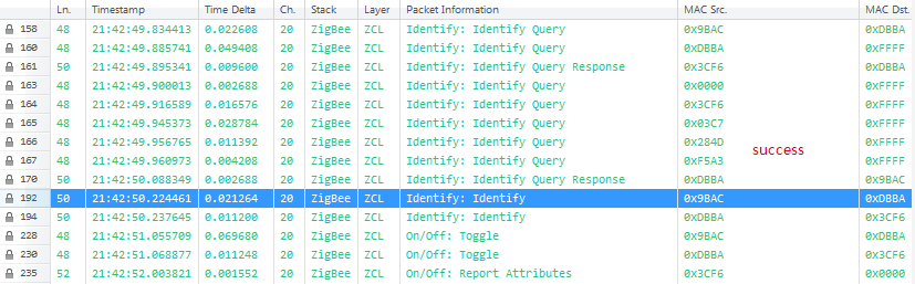

I have some question about F&B。The project I used is AN-1217 Router and End device.
The first one:
It success F&B most of time but sometimes get failure.
I printf the sniffer log as below. It seems that the end device did not send  Identify packet,but sometimes did.
Another question is when I SendOnOffCommand after the end device rejoin network, sometimes will send failed and it got an error with "0x83" ZPS_APL_ZDP_E_NOT_ACTIVE
Once the error happened ,the end device will not go deepsleep,it seem that end device address had been lost,and it request Data from its Parent all the time.
Thank a lot.

Did you follow the process described in the AN documentation? I am not seeing the bind request and the bind response.
Please see the file attached.
